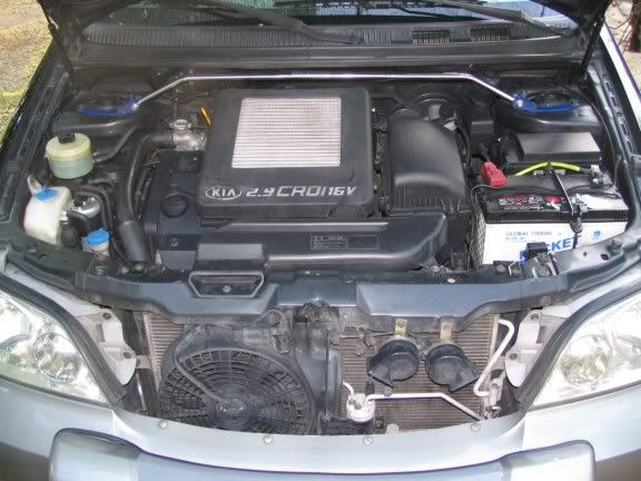

    I had my strut bushing replaced under warranty but the noise is still there. I've heard the same noise from my 90 corolla and nissan urvan, don't know if ano talaga siya.
    i plan to upgrade the horn. medyo bakla pakinggan..... i want a more manly sound :D syempre lagyan ng relay para buo ang tunog!
    I installed the black bosch horns. Mas macho yung silver, pero mahaal!! Mas masakit sa tenga yung hella na red, pero mas type ko yung deep solid sound, mas bagay sa sedona/carnival.
    i also plan to upgrade my headlight wattage. hindi naman hi tech... yung tipong 100/90 watts lang. accdg to my friedn who owns the shop, i need to buy a wiring kit with relays for this. pwede daw i-DIY ito. everything is there sa kit. has anyone tried this? coz another friend said that kung 100/90 lang, di na daw kailangan ng wiring kit. true?
    Mine has wiring kit. H7 ang headlight bulbs ng sedona, I don't know with the carnival. Better to install wiring kits because it helps your alternator na hindi masyado mahirapan. Especially with mine I changed all 4 headlight bulbs to 100watts.
    so far, eto pa lang ang nagagawa ko sa carnival ko. future plan is put a more decent sound system, change tint (nag start na mag blue color kasi) and probably a roof carrier. anyone has installed a roof carrier?
    Nope, OEM yung roof racks ko. Regarding tints, if you like to have the front full tinted, there are some tints that can be one piece in the front. If the shade you want has to be yung may hiwa, suggest yung hiwa nasa lower, not the typical na upper visor cut. Mas di distracting. Sound system, I mentioned my setup several pages back, but that's for the sedona. But should be the same with the carnival series.
    thanks for reading
    Hope I've helped.
