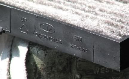

    leolop:: Pasensya na sir at hindi ko na nakuhanan ang pics ng makina, tinoxic ako ng anak ko sa assignment nya. Ang lupit magbigay ng assignment ang mga grade school ngayon, kailangan talaga may computer at Internet connection ka sa bahay.
    Anyway, I hope you were able to observe how the casa guy got the engine number so you can do it by yourself next time.

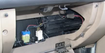

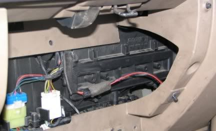

    the fuse box assignments photos you posted are really helpful! at last, baka makikita ko na kung bakit di gumagana yung aux fan ko behind the radiator. punta ako electrician tomorrow. re the baguio climb, it rained along the way but my new dunlops didn't mind it. i have been up and down kennon road so many times that i make yabang to my former classmates that i can even traverse it in reverse!
