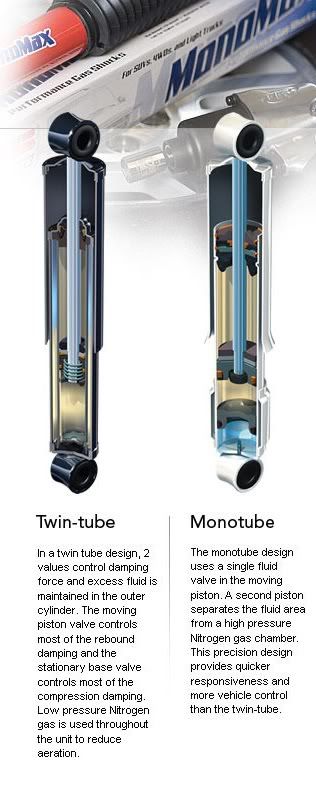

    My shocks have arrived! :D
    Hope to have them installed this week.
