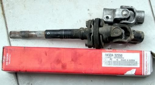

    THE CULPRIT
    that's the intermediate shaft and the steering coupling, also known as the upper and lower steering couplings.
    The steering intermediate shaft is a significant vehicle safety item that connects the steering column to the steering gear box. The primary function is to transmit torque reliably through angles while dampening noise, vibration and harshness from the driver. Another key function is to enhance occupant safety through the use of energy management features. These help the vehicle conform to government and industry collision safety regulations.
    from timken.com
    i had the repairs done at kia new manila (wheels) and all parts were sourced from goodgear.
    replacement of steering couplings: P6,240.00
    2,490 - labor
    1,950 - intermediate shaft
    1,100 - steering coupling
    700 - power steering repair kit
    since this was a casa, they also suggested that the rack and pinion be overhauled. siempre, yes naman ako... as long as they let me source all the parts needed. payag naman sila.
    overhaul of rack and pinion: P 2,610.00
    2,490 - labor
    120 - rack and pinion bushing
    the right side front wheel bearing also needed to be replaced. i opted to have the left done too even thought that side seemed good yet.
    replacement of front wheel hub bearings: P 4,845.00
    1,245 - labor
    3,000 - front wheel bearings (2 sets)
    100 - wheel oil seal (2 sets)
    500 - pressing (machine shop)
    on hindsight, it could have been more convenient for me to have the repairs done at kia pasay since it is much nearer to goodgear. they also quoted less for the labor when i made a phone inquiry last week. but i was not sure if kia pasay service will allow me to source parts elsewhere.
    mikey177::: driving down kennon road was surprisingly easy. maybe because i've been driving around town in baguio with the heavy steering for a week doing the hatid-sundo school bus run. the steering was ok at highway speeds, the only adjustment i had to make was to make a deliberate effort to center back the steering wheel after making a turn. we left baguio around 230am and my wife and i were in jona's QC main branch at 630am - the first customers for the day.
    benchph1::: my unit is the sedona here and so is altec's and mikey177's. looks like this steering issue isn't quite resolved for the sedona yet. the heavy front end of our vehicle seems to be the cause. the new carnival has a lighter GVW kaya i think this will be less of a problem with the newer generation na.
    too bad to hear that they charged you 30k over at signet. those casas really make a killing by charging a premium on parts and service. i easily saved around 9k over the parts cost from wheels by sourcing the parts myself. not a bad return with just a phone call,several texts and a little legwork.
    pilot::: nothing that we can do about it afaik. adjust na lang ng adjust. ako? i just rely on my cellphone's clock.
