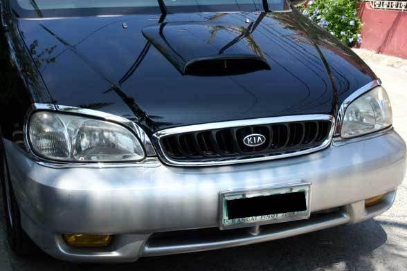

    Gen 1 Carnival LS nga yung unit mo, shauntot. Yung mga RS kasi monotone, yung LS ang may two-tone body color. Mukhang maganda at sariwa pa yung unit mo, congrats.
    Yung card holder sa dashboard, sa Gen 2 Sedona RS nagsimula yon. It's located where your power side mirror controls are (the side mirror controls for the Gen 2 are on the driver side door already).

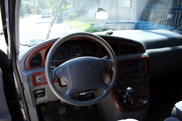

    tnx for confiming sir mikey, sana nga walang problema, makinis pa naman siya kahit papano. walang choke sa dash, or baka hndi ko lang nakikita. anywhere specific i need to look? medyo malakas nga vibration pag cold start pero pag tagal nawawala rin

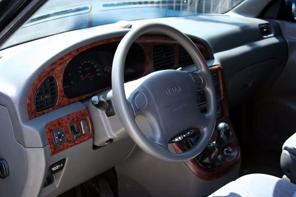

    shauntot,
    check out the lower left portion of the second-to-the-last photo you posted (kia2.jpg). Dun sa ilalim ng dash, below the fuel filler lid release and parking brake release, there's a small circle with a yellow marking. Isn't that the choke knob? That's approximately where mine is located.
    60
    #1375
    mikey - sharp eye sir! oo nga no, meron. tingnan ko nga mamaya. pardon my ignorance but this is a 1st for me, san/when mismo ginagamit yang choke? alam ko meron pajero ko din nun, but never had to use so i don't really know :D

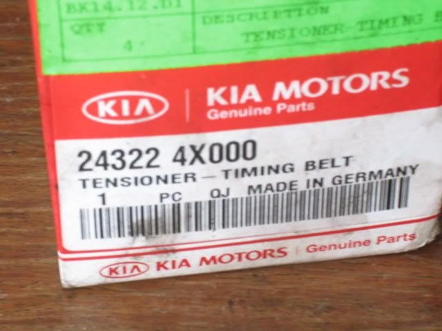

    useless naman yung choke knob na yan eh. ours also have one. pero disabled. automatic choke na ang j3 engine.
    ngapala welcome shauntot!

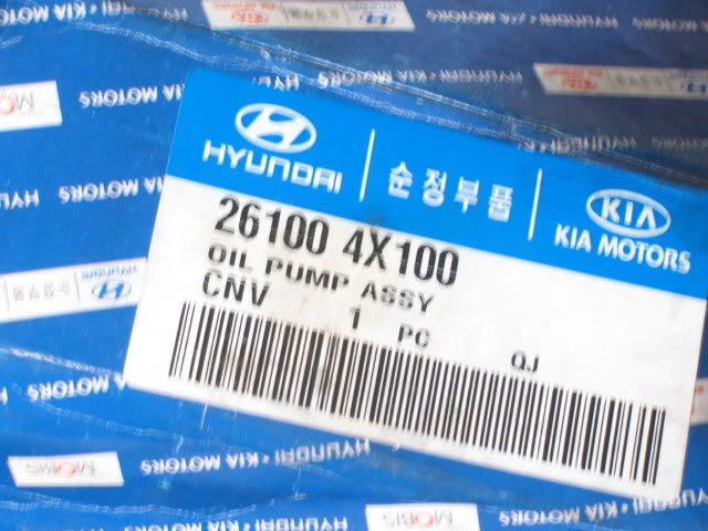

    as promised guys here are the pics of the parts i replaced:
    OIL PUMP
    eto yung nagproproduce ng grinding sound pag palitin na.
    2,639
    #1377
    26100 4x100 - oil pump assembly

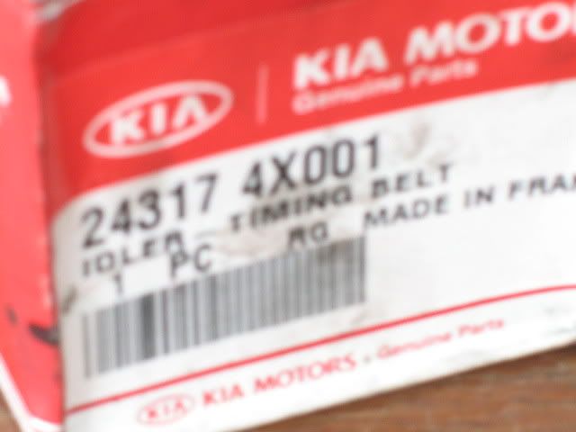

    timing belt
    2,639

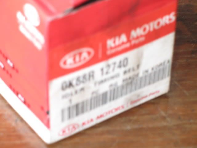

    OK55R 12740 - TIMING BELT IDLER 1

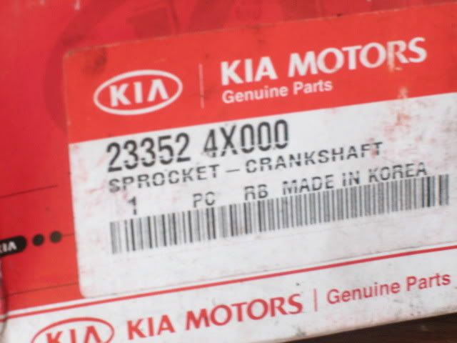

    CRANKSHAFT SPROCKET

    TIMING BELT TENSIONER

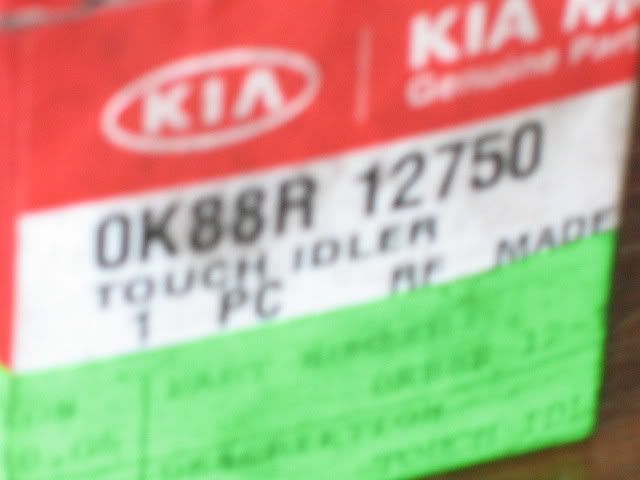

    #1379
    TOUCH IDLER

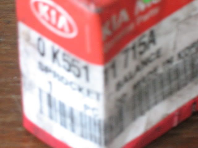

    SPROCKET BALANCE

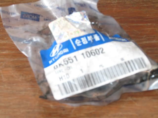

    OIL SEALS

    made in germany, france & korea pala ang spare parts ng kia.
    mahal yung mga nanggagaling sa germany.
