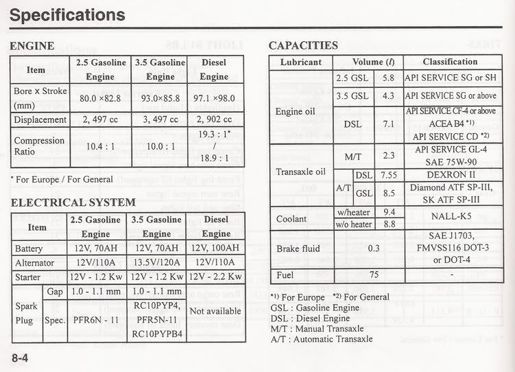

    Hi KCar peeps,
    Does anybody know if any of the local gasoline player ATF is compatible to our Kia Car recommended ATF, Dexron II E/III M? I noticed that Mobil is also DexronII E compatible. How about the coolant, any recommended brand as well?

    Quote Originally Posted by hinlog View Post
    Hi KCar peeps,
    Thanks in advance.
    hinlog, dexron III atf should be ok with your car. mine is on ac delco dexron III. i would have wanted to try out diamond SP-III as it is specifically designed for front wheel drive A/Ts. diamond SP-III is not sold in the auto shops in baguio city but i heard that they are sold in mitsubishi service centers at around P600/liter.
    BUT: somebody posted of poor transmission performance with dexron III which was promptly fixed when it was flushed out with dexron II. the only dexron II i've ever seen lately was valvoline's dexron IIe.
