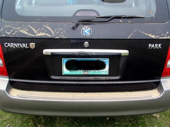

  6. #2126
    singit-singit...ask ko lang kung ok sa price nya at kung matatawaran ko pa mga magkano kaya?
    2003 kia carnival park II crdi, 66T kms, full options, leather seatcover has no cracks, well, sound of the engine is like the sound of a typical carnival(but louder sa new 2007 engine ha), AT engages smoothly, but needs detailing (mantsa build up on the doors) no oil drips
    asking 400T... what are the things i should be of more concern....

  9. #2129
    yup it looks nice talaga... maalaga yung owner(coding car lang din)
    a so t.belt, bearing, ATF??
    yung power-rear vent window di masyado nabubuksan--i heard the rubber unstuck once i opend it (and the owner dont know much about the feature)..may time ako magisip kahit paano--ung owner wala masyadong plans ibenta ung van,e...sa akin lang nalaman na pinost pala ng pamangkin nya ata...
    2 uri lang naman ng carnival-sedona hanap ko--imported CRDi-park edition, or LS-manual..salamatz!
