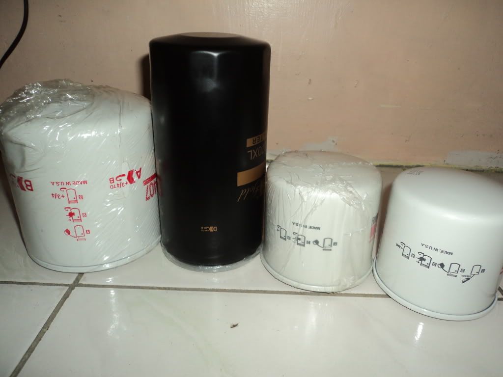

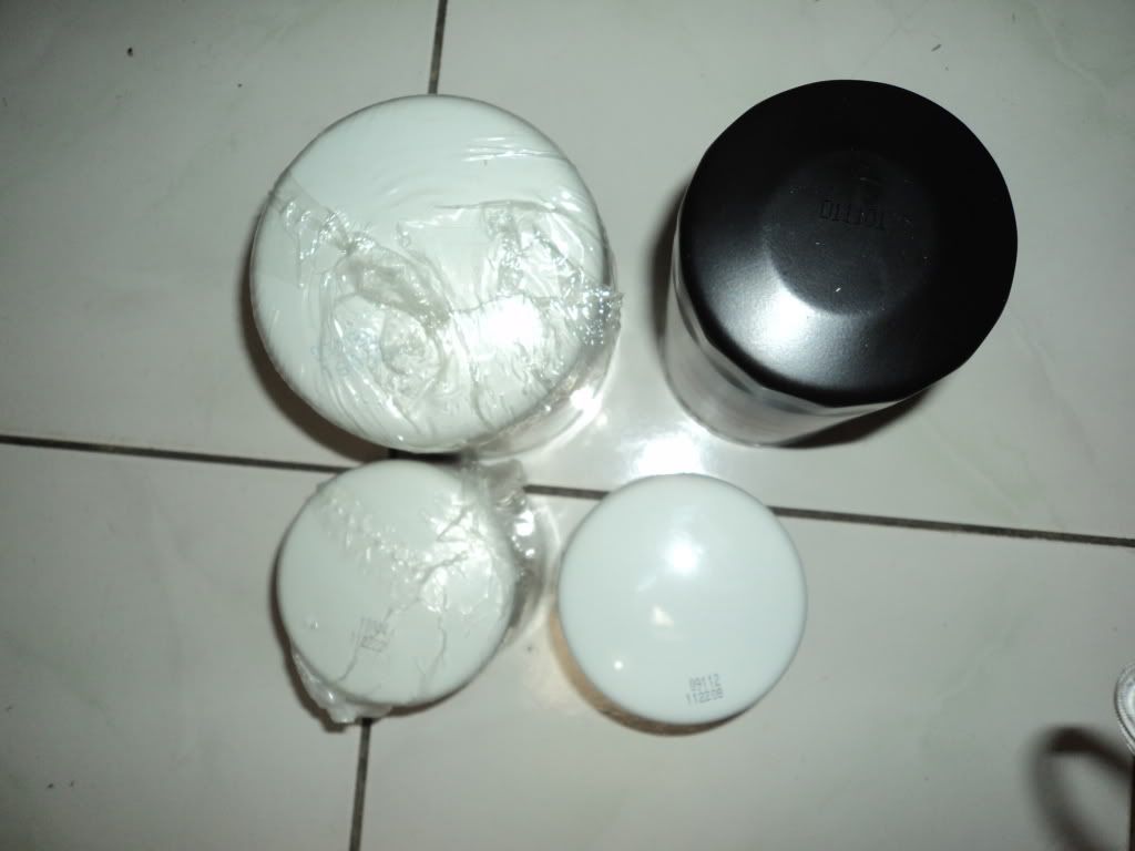

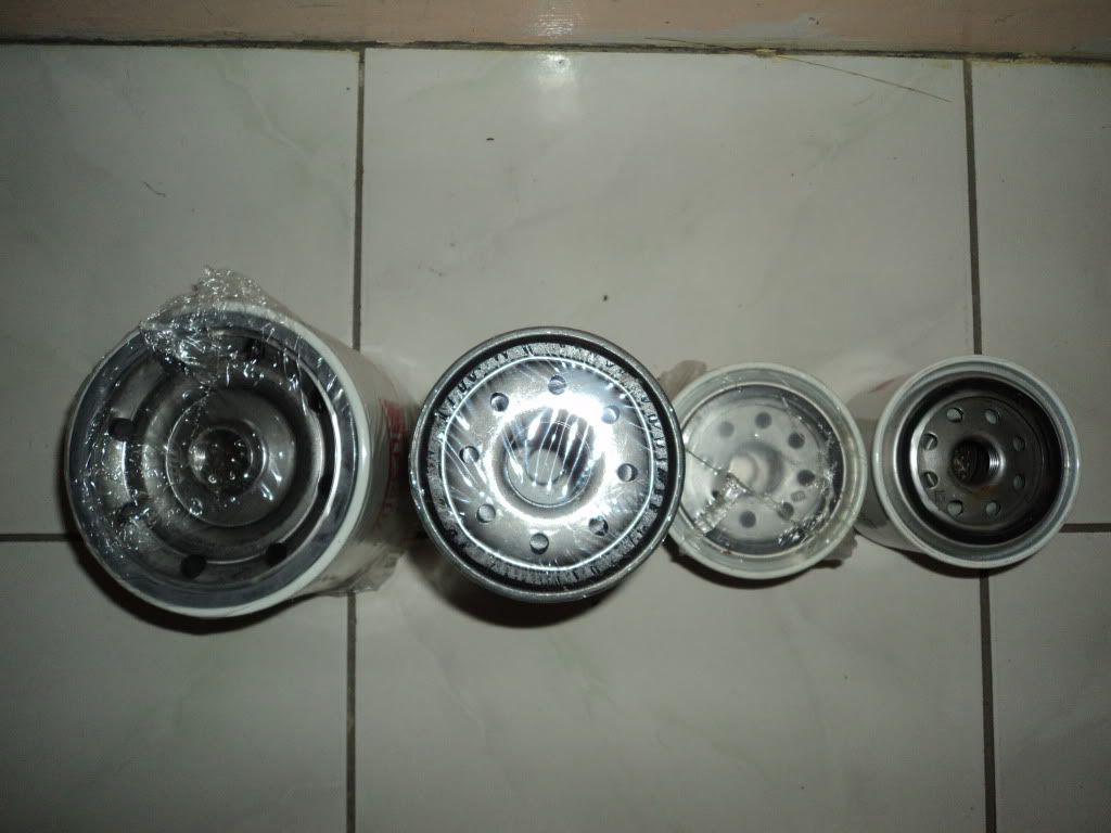

    The main thing is no country of origin, plastic only covering the bottom of the filter, no zulu date code on the top of filter, poor paint or lettering, ect.
    You can also look up the actual picture of the filter on the Fleetguard site or on the internet.
    *miko1011130 I'm surprised to hear that Titan gold looked like that, possibly not a original because it should be a metal center tube on all of them.
    Here's a example of real Fleetguards that have been purchased in the Philippines and a Titan Gold. (they do have plastic at the bottom) But should be just as heavy duty as a Fleetguard. The ones people have told me they have gotten were very high quality like the one below which is From Pacer. But you know how fakes like to sneak in.
    sir are you saying Pacer is selling high quality fake fleetguard?
    do you have any idea of the price of genuine fleetguard that fits 4d56 engine?

    They do have some that are defiently not the real deal, It's a mixed lot with those guys. They also have some that are made in Malaysia which the quality is way below the US made Fleetguards.
    This is not normal Fleetguard quality. But this is what they have for that filter. I would stick with the Baldwin, OEM or Bosch vs these. If the Fleetguard does not say made in USA or other major country above the filter install diagram I just avoid them all together. The low quality filters will not have any country of origin on them. The Pacer guy came on the forum but could not answer the problem with the quality of the filters we questioned.
    The overflowing non standard glue is very disturbing.
