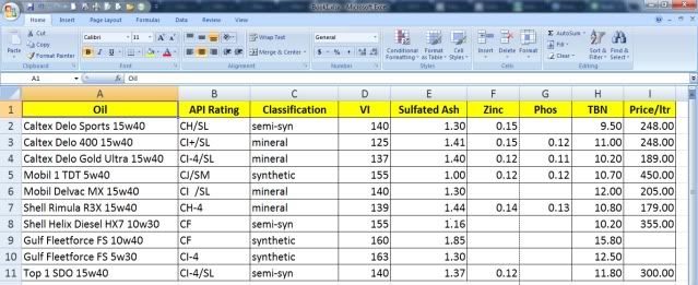

    I made some comparison of diesel oils popular here. HTH in your quest of the ideal oil for you. Prices are based here in my place so it will vary.
    Some are also made to order like Gulf oils na direct sa national distributor and per case dapat order. Cheap per liter but expensive as a whole.
    Surprised that the TBN nung MX is 12, I think those are the US spec sheets since synthetic ata yun but dito sa Asia mineral lng po ata thats why TBN is 10
    Surprised that the TBN of MX is 12, US specs po ata yun since synthetic , yng sa Asia 10 lng po since mineral sya
