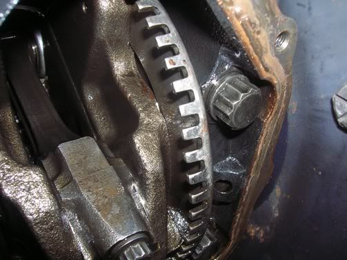

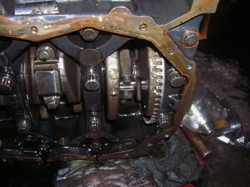

    Is the CKP rotor on a diesel engine vital to engine starting? We overhauled a diesel Hyundai Santa Fe and were not able to make it start ever since. After a co-mechanic suggested the CKP, we tore down the engine again and noticed the wheel with several notches bent..
