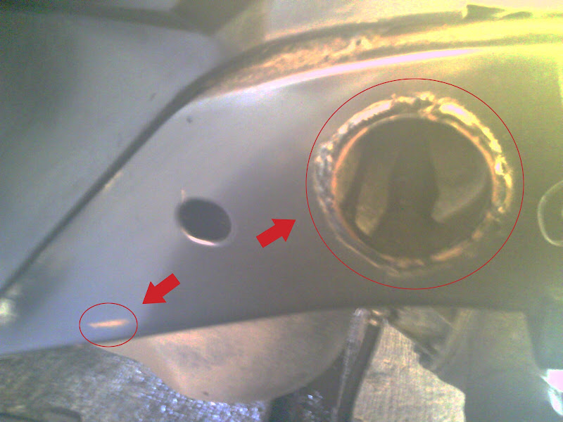

    mga boss! i took my strada for a carwash this afternoon, and i noticed some rust forming in the rear chassis:
    just wanna ask if this is normal, or should i bring my truck back to the casa for rustproofing? TIA!

    Surface rust lang siya, I think.
    Sand and paint over is possible. It won't rust through. Had something like that on my Pajero. Nabenta ko na hindi naman kumalat or tumagos.

    wala yan bro...lahat ng strada pwera lang yung nasa showroom meron nyan hehe...solusyon? fine sand paper tapos black paint in cotton buds hehe...tanggal yan....saka if ever man na mag alala ka...dapat yung rust sa mismong body....kasi pag chassis, kung baga...pudpod na ang ngipin ng kalawang inde pa nangangalahati yung thickness ng chassis mo...
