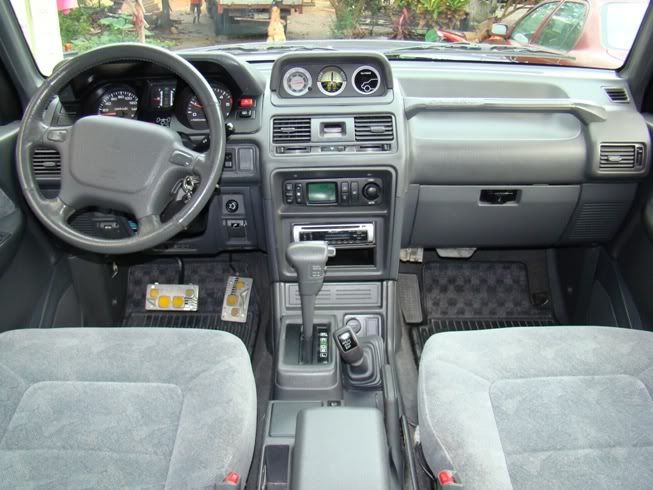

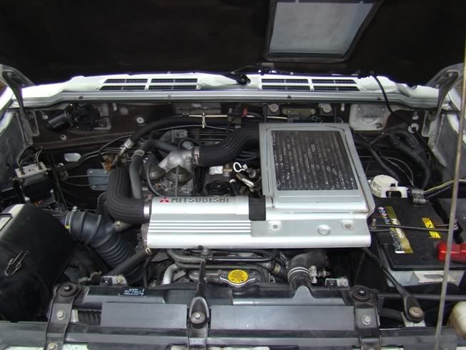

    Hi sirs!
    I got my Pajero from Subic
    it's a 1996 Exceed with 2.800 Diesel Engine A/T.
    Sirs, since I am a newbie, I humbly ask for your assistance with my Pajero.
    It has a lot of problems. Any suggestions would be very very much welcome.
    Problems:
    1. Sunroof leak: Motor not working properly also. Do you know where I can have this fixed po?
    2. Camber misaligned and Matagtag: I think i need to have the shock absorbers and springs changed. Do you know any local surplus shop where I can have it fixed po?
    3. Power steering fluid leak: I am having problems with this every month. I have to put fluid once a month kasi nauubos.
    4. Electricals and Airconditioning: The switches near the headunit for the aircone and other dials like the compass are not working... anyone knows where i can get a cheap/pulido na fix?
    THANK YOU THANK YOU in Advance!
    Looking forward po.

    hello sir, jdm pajero owner din po ako and same model sa inyo. so sagutin ko mga queries nyo to the best that i can po...
    1. recently ko lang din na-encounter ang problem sa leaking sunroof. what i did, binuksan namin ng erpats ko ang sunroof at nilinis ang passageways niya at yun drain niya. sundot sundot lang naman yun and clogging ang problem nito dahil madumi na. pero as for the motor, i had mine working very fine. baklasin nyo po yun ceiling niya, andun po ang motor at pwede nyo i-check yun
    2. try also checking your ball joints and bushings sir. i had mine replaced 2 months after i acquired my pajero. puro oem ang pinalit ko.
    3. hmmmm, eto din ang isa sa mga problema ko noon. ano ang dahilan? o-ring... yan ang madalas na problema niyan sir. pag nagawa niyo na yan, the last thing to check is the steering gearbox kung may leak na mga oil seals niya
    4. yun compass ko, hindi na working. hindi namin ma-trace kung maling electrical wiring lang o defective talaga. kasi ang ilaw para dun eh hindi rin nagana nung binaklas namin, pero buo pa yun bulb ah. at dun sa aircon, its the climate controller po yun. dapat working yan kasi pag hindi, wala kang aircon. describe nyo nga po sa akin yun problem about that...
