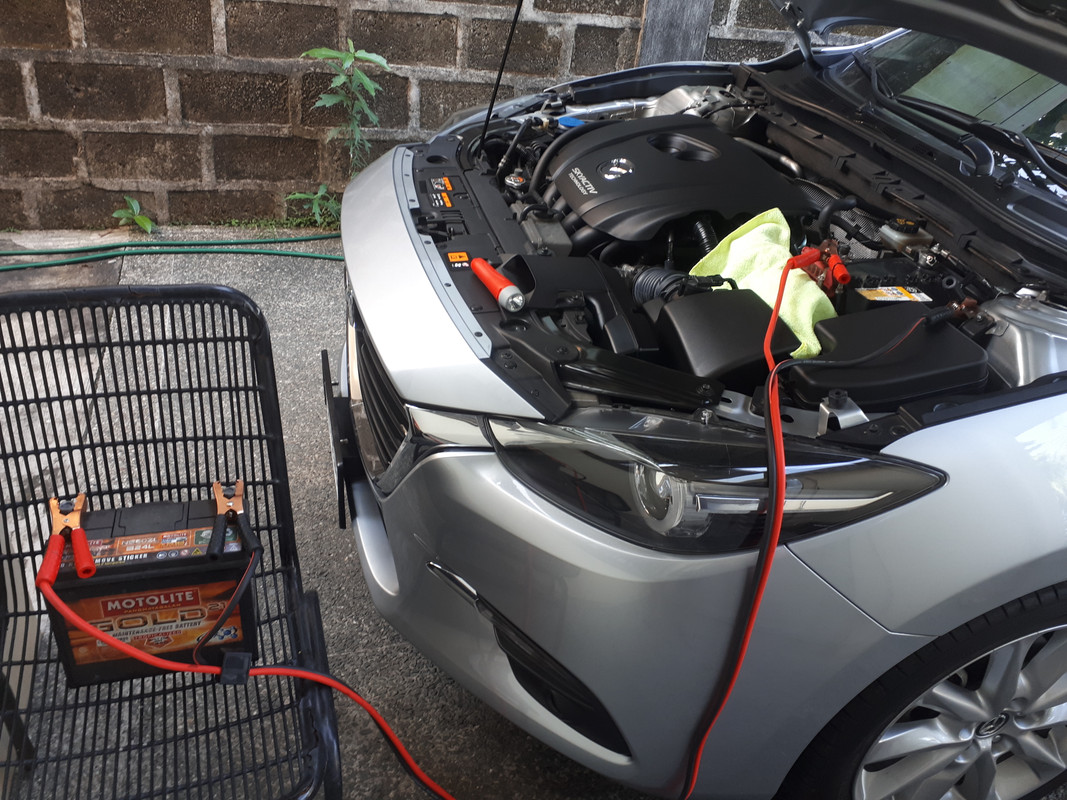

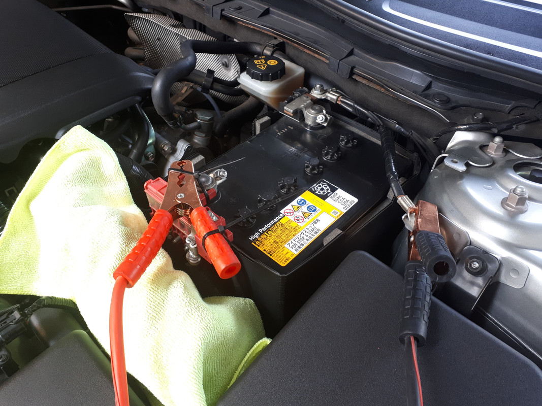

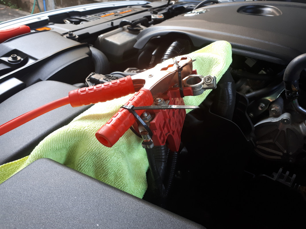

    Hobo method of replacing the car battery: connect another battery to the car's battery terminal connections before removing the car battery. I opted for this approach instead of replacing the EFB battery while the engine is running (not recommended due to the huge risk of damaging your car's electronic components).
    This hobo method will keep the car's ecu powered, hence no risk of losing the istop configuration and infotainment system settings. Just be careful not to short circuit the battery connections (battery positive connection shouldn't touch the car's metal body, negative terminal).
    A safer approach is to use a portable battery jump starter that comes with a powerbank. As long as there's power supply to the car's battery connection while removing the battery, those ecu settings will remain intact.

    iStop may or may not need resetting after batt swaps. Hit/miss. I dunno who advised the risky method of having the engine run upon batt removal. I'd never do that. You did the right thing, jojo sir.[emoji106]

    Haha, I was short of cash to buy a powerbank car battery jump-start gadget, and I needed to replace the battery asap for an upcoming trip to the Great Northern Mountain Road Trip. The Yuasa battery that I bought made a huge hole at my wallet [emoji24]
