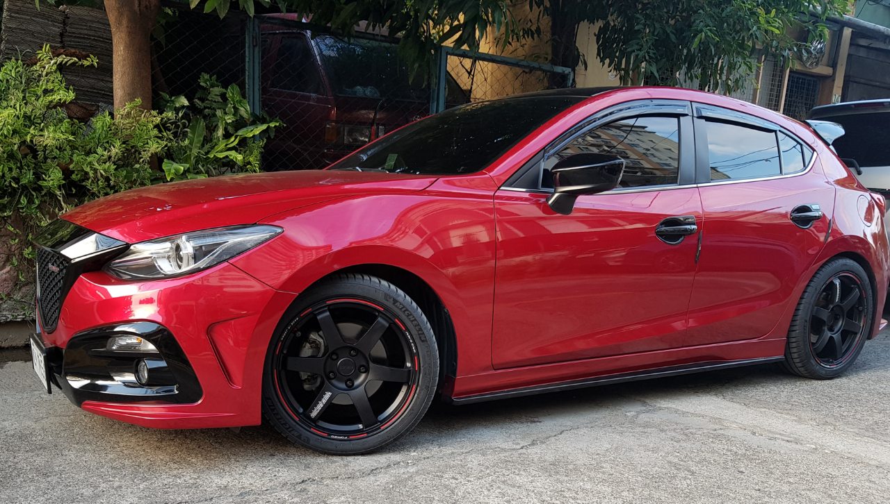

    Here's a good guide to the ultimate Wheel/Tire Combo for the BM/BN:
    Meaty, Beefy, Comfy, Grippy
    Michelin Pilot Sport 4 (245/45/17): 11.05kg
    Rota Titan 17x8 et42 Hyperblack: 7.85kg
    ....And LIGHT!!!! Wheel+Tire: 18.9kg
    Best of all....the setup doesn't set you back much!!!!
    Photos courtesy of OVTph.
    I found myself looking back again with these nice set of wheels for references on rim size options that will provide a more comfortable ride and peace of mind when driving on pothole infested roads. My plan is to have my stock R18 rims replaced with something that is more suited for bad road conditions.
    Sir Travs, judging from the looks of the tire side walls from the pics, it seems that these are size 50 or 55 and not 45. What do you think?
    What if I go for the R16 rim size and with 205/55 set of tires? Is this the same OEM size for the M3 1.5L variant?
    Those are 245/45/17s, jojo sir. They give 13.5mm higher sidewall than your stock 215/45/18s while pretty much retaining stock outer tire diameter.
    Going 245/50/16 will yield you 25.75mm more sidewall than stock.
    Comfort isn't all by the sidewall alone. Different tire brands & models vary in sidewall stiffness. Wheel/Tire combo weight affects suspension & steering dynamics, too. The lighter, the more forgiving.
    The 3's fitment options have long been toyed with. Have no doubts...no guinea-ing needed now.[emoji4]
    Please share us your desires, sir.....Your call, of course, to either include or spare us the kinky ones.[emoji16]

    Pics for the new shoes please [emoji6]
    Nov 2017
    1,962
    #3700
    Quote Originally Posted by b0r3l View Post
    No Rattling on stand still. Already brought to Casa for checking before my Yojin expires.
    Also installed new shoes.
    Nice! Are those Rota Grid R17?
