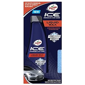

    okay na kaya ito for my Red Nissan Juke?

    yup yan yung new packaging nung TW ICE na SPRAY wax na pinakyaw ko hehehe. ganda yan bro, siguro mga less than a month (2x a month for me kung yan gamitin ko). pero mas durable parin talaga yung TW ICE liquid wax
    TURTLE WAX(R) ICE(R) LIQUID WAX
