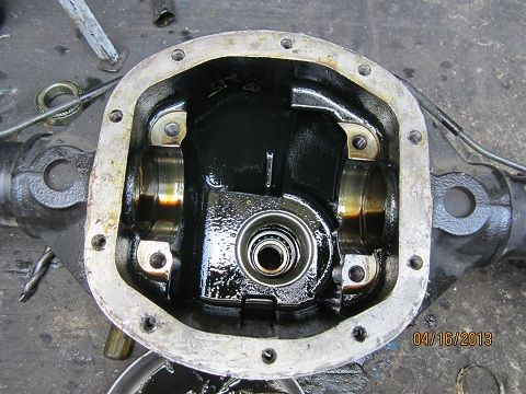

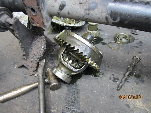

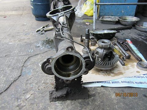

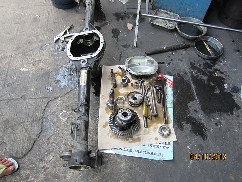

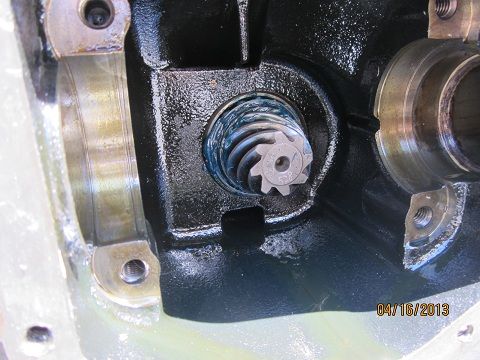

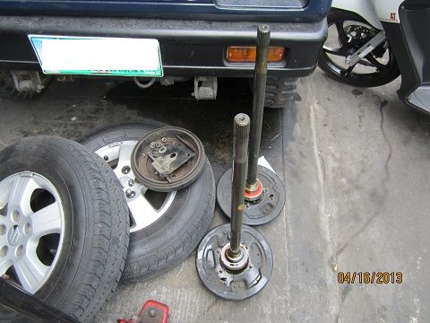

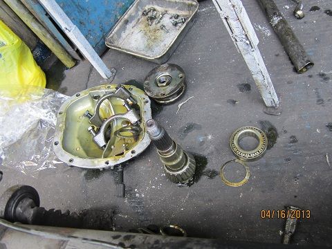

    My mechanic referred a machine shop to try to fix my apv's rear differential noise.
    I took it to the shop yesterday and they pull down the assembly.
    93
    #1574
    All the bearings were still good and they cleaned all the parts
    today.
    They put back the polished pinion this afternoon.
    According to them, the pinion & ring gear were very tight wherein
    the shims were damage. The spacers were also not installed correctly
    by the previous shop. The pinion & ring gear were not damage though
    and just undergone polishing today. They will now try to return the
    correct spacer and shims.

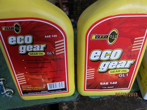

    I also went to Banawe St. in Quezon City this afternoon to buy SAE140 gear oils.
    Looks like they can fix the humming noise.
    93

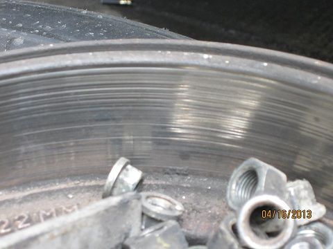

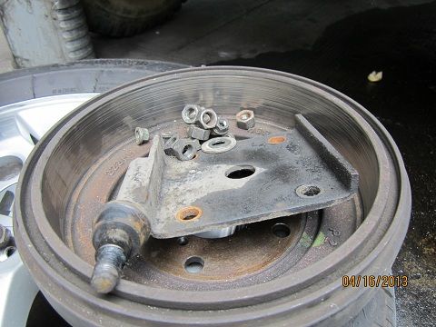

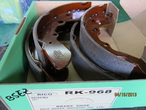

    I just found out today that the two brake drum of my apv needs to be
    reface due these scratches inside maybe made by a worn out brake
    lining. I think the previous owner kept using it wherein the metal part
    of the shoes were already in contact with the drums inside.

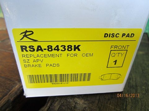

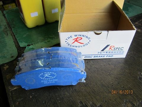

    Bought a set of brake shoes and pads today. The store offered
    me a bendix brand but I decided to get the replacements.
    The brake shoes cost about 1,100.00 Php.
    The brake pads cost about 750.00 Php.
    I experience a vibration on the brake pedal when I am braking
    down from 100 kph. My mechanic advice me to also replace the
    brake pads to eliminate this problem.

    * kenko thanks for the photos, very informative, mukhang mali yung diagnostic ng casa regarding sa humming sound

    *Keno, if same R Specs brake pads yan tulad ng nabibili sa mga hyundai/kia shops, kindly observe them kasi based sa experience ko, matigas material nya...nakakasira sa rotors...imbes na pads nauupod, rotors ang nadadali...paalala lang...

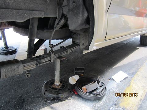

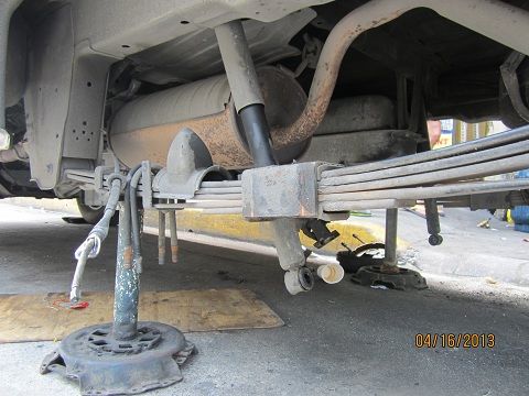

    *Keno

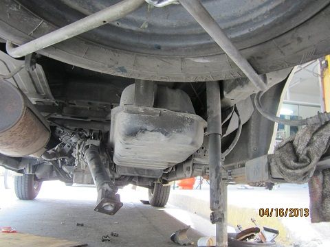

    Katakot yung steady jack ng mekaniko mo..hehe
    Mas Ok yata GL4 sa axle. Madami siguro skipped PMS ang previous owner

    * keno thanks for the photos, very informative, mukhang mali yung diagnostic ng casa regarding sa humming sound
    Thank you sir victorevolution, I think when CASA test drive my apv and heard the noise,
    they did not check it thoroughly and just assumed it was coming from the transmission.
    Anyway, it still pays to have somebody else take a look at the problem. Although the car
    shop that fixed my apv did not do it correctly, I think this machine shop now knows how
    to correct the problem.
    Thank you sir mateomarco, that is the sad thing about buying replacement parts
    were in it may not be as effective as the original. I think the original brake pads
    cost about 5k Php but I still bought the replacement because of the price difference.
    Anyway, I will observe this R specs brake pads and post feed backs.
    *Keno
    Yes sir 12vdc, the steady jacks were scary and my apv was parked on the road!
    If something would hit the apv, the jacks will definitely loose it's support on the car.
    I was not familiar with those GL1, GL4 or SAE-90 or SAE-140. When I was at the
    store, I decide to put the thicker one and they recommend the SAE-140.
    I assume that the higher SAE value would be thicker? So that the gears would be
    quieter ?
    Yes sir, I think the previous owner did not do those PMS because the differential
    oil was very dirty when I had it change last year.
    Re vibration when braking, i end up replacing the front right rotor & new pads. May tama din ang wheel bearing, tuyot na.
    I hope the new pads will solve this and if not the shop will need to reface the
    disc rotor. I will have my mechanic check the bearing also, will see what
    happens tomorrow's test drive. Thank you again for the info sir.

    *kenko 3k lang po yung pads sa casa, i've been to suzuki a while ago but still the replacement that you bought are still way cheaper
