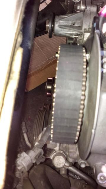

    old timing belt - 60 thousand kilometers traveled - still looking good. but I just wanted to make sure na din.

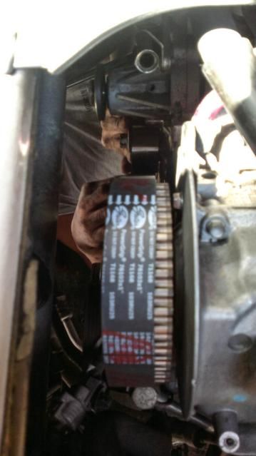

    new timing belt

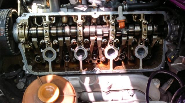

    tappet spacing check.. I already had my tune-up around a year ago.. I just wanted to make sure my tappets ; camshaft and internals is still healthy and tight so my mechanic checked it for me.. just to make sure -- cam bolts and screws re-tightened.
