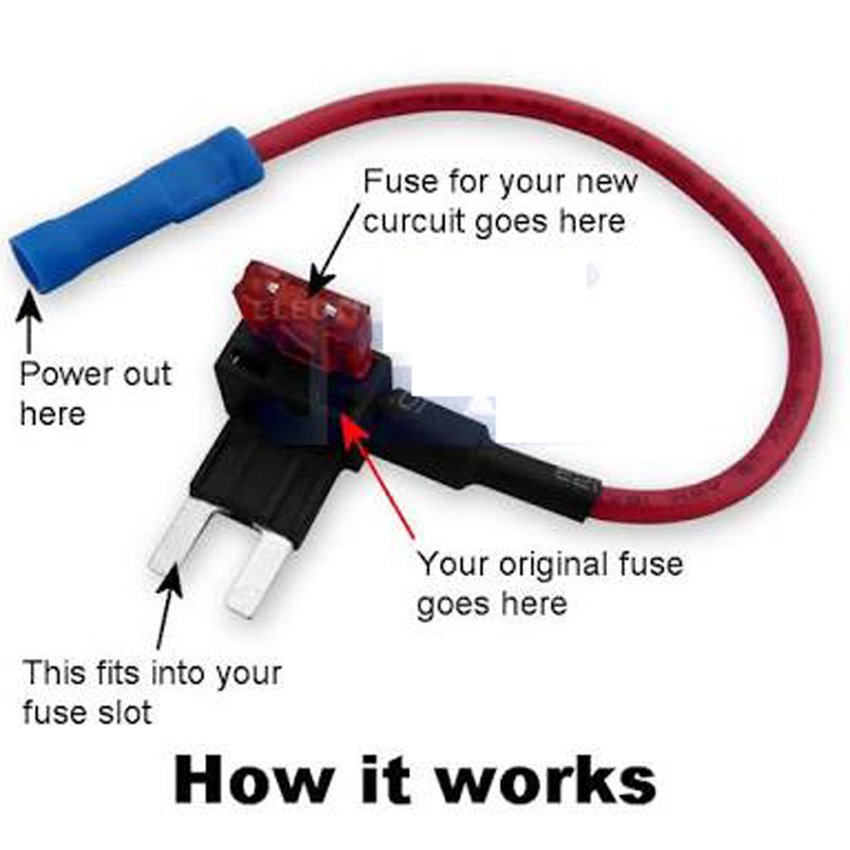

    Better to have done a fuse tap ...

    Is that where they’ll tap to the unused fuse slot of the car?

    Normally you piggy back it on top of a fuse that gets power when switch is in ACC or ON position ... search for fuse tap ... you can buy some from D3Tech on Facebook or Lazada or olx ... it's quite easy to DIY ...

    Cool! Thanks for this!
