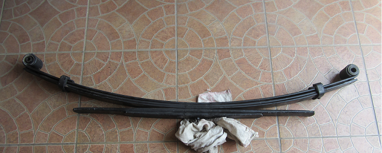

    Finally my rear suspension project is done! We took off the stock 4x2 leaf pack and this is what it looks like:
    Doesn't look too bad when it's not supporting the truck but these are close to shot when installed (see before pic). The thing I don't like about the OEM 4x2 leaf pack is the main and second leaves. If you look closely you can see they are the same length. They will move like one thick main leaf, not good for ride quality. So what we have is practically one thick main leaf, one shorter leaf, and two thick overload leaves that are just act as bump stops.
    I wanted to cut the second leaf to get better leaf stepping but wasn't sure how many leaves yet we could go. Too many leaves would lift the rear so high I might need a drop bracket kit for the front. Not happening as it's too expensive! So we left the first 2 leaves alone for now. Ended up getting 2 donor leaves of the same thickness (8 or 9mm?) from an automotive ukay-ukay near Banawe. The 2 leaves have more curve to them, and will make the leaf pack more progressive. We removed the last overload and flipped the longer overload. I stuck to the stock length rear Bilstein shocks as they still don't limit droop at full extension. And voila!
    Before:
    After:
    Total lift for the rear is around 2". Tires look really small now, LOL. First impressions, the ride is now much more comfortable even without load in the back. And smaller bumps are barely in the cabin. I'll revisit cutting the second leaf if things get too stiff in the future but for now, this setup is not bad at all for a few K's worth of parts.
    linis ah :D akala ko pati diffs nagpalit ka din hehe, balik mo ext shackle mo mga 4 inch lift yan sa likod :D

    Linis nga, pininturahan ba o pinunasan ng used oyl?
