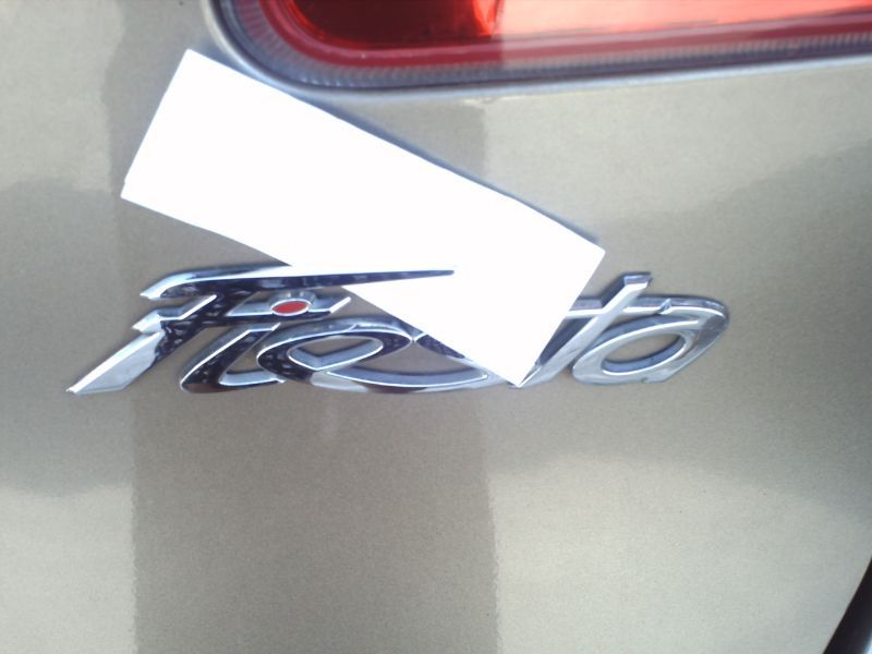

    Another heads up guys: The adhesive (actually double sided tape) for our badge seems to be of inferior quality. I noticed that it already came off at the top part of the "F" despite normal use and washing. A piece of paper can be easily inserted:
    I set out to do a preventive measure before it falls of or maybe get a part broken off. Here is simple guide to share with you kids:

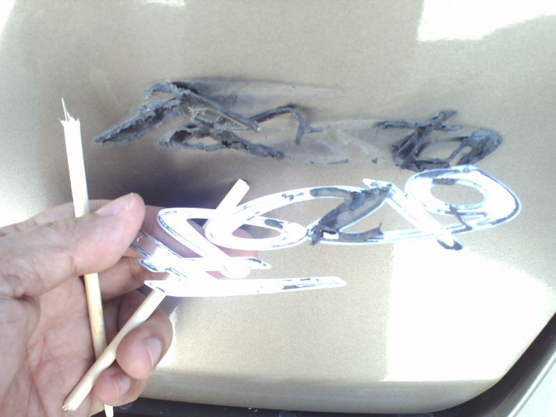

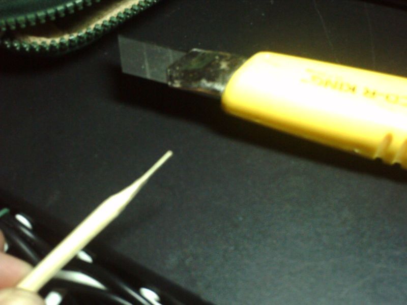

    Get a soft tool that will not scratch the paint. Pwede yung panghalo ng epoxy or meron din commercial na prying tool. I just used what is available, a bamboo chopstick. Shave it with a blade cutter so that you get a chisel shape.
    It turned out I needed 2 chisels at the bottom part of the badge.

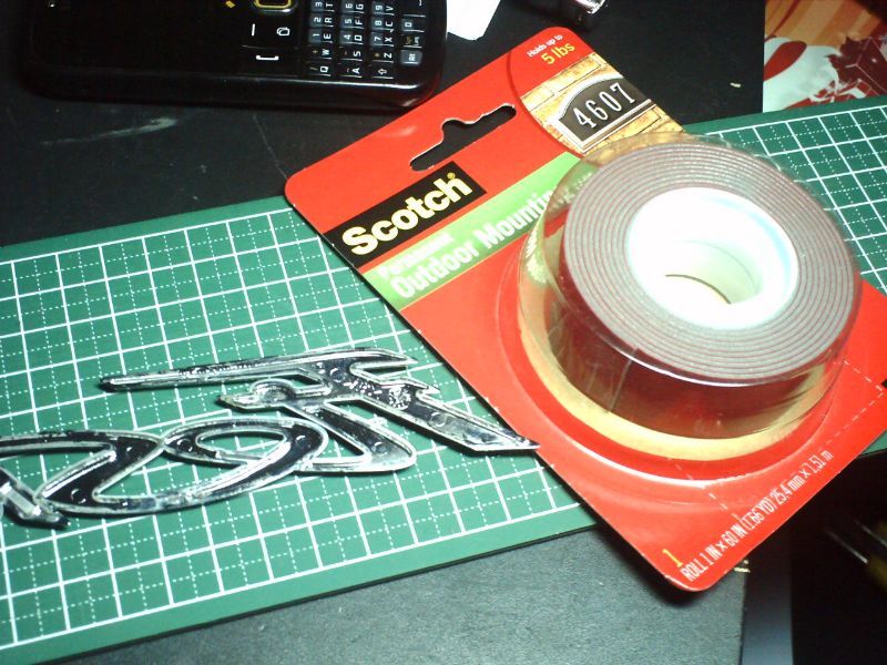

    Once peeled off, I confirm the lower quality double sided tape compared with 3M (pagtitipid as we have often talked about)
    Thorough cleaning of both the badge and the LiMo's butt, I'm ready for 3M's Permanent Outdoor Mounting Tape. Red color sya and I understand dito sa forum na matibay to so much it is used for attaching body kits.

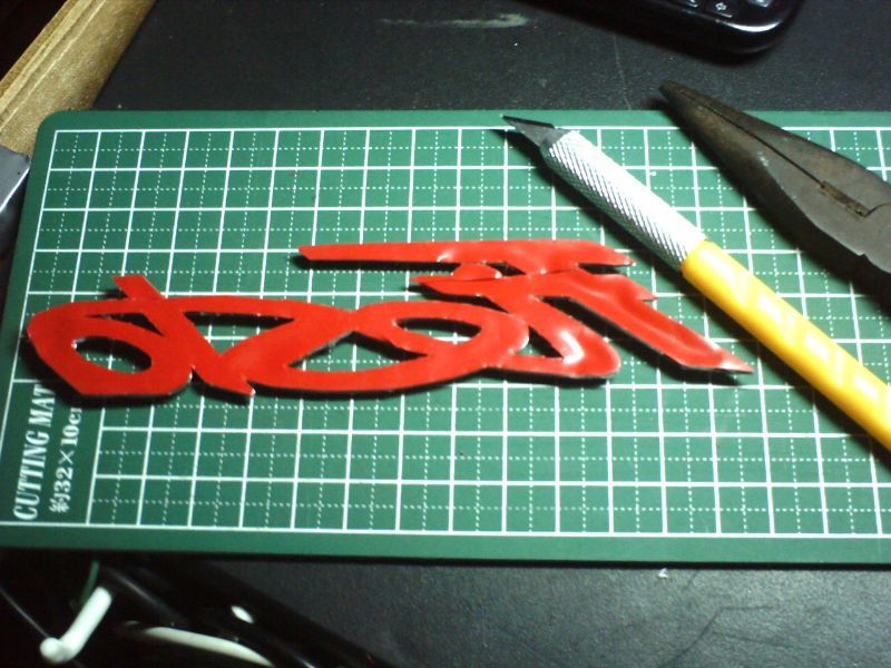

    Tapal ng tape sa likod at wag muna tanggalin yung red backing while trimming.
    Konting tyaga sa trimming and it should look like this: (red backing still intact)

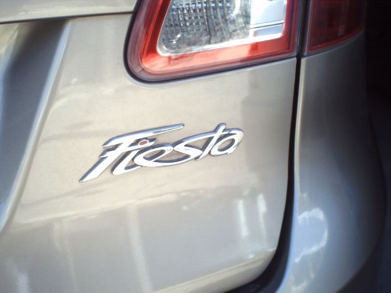

    Pag satisfied na sa neatness (ako hindi masyado maselan gaya ni Ninong Mar, I'm sure ordinary people will not notice tiny imperfections in trimming), balik na sya sa pwet. Yung sa akin me marka na ng word na Fiesta dahil pag naghuhugas tayo hindi na inaabutan yung pinaka singit, secondly hindi inaabot ng araw yung ilalim ng badge. Yung marka ang pinaka guide sa pag-soli.
    Eto na sya, sure ko lang mas matibay sa original.
