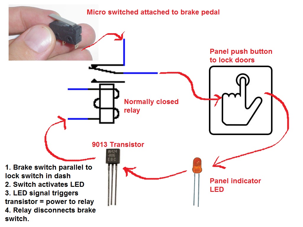

    Continuing my first post:
    http://tsikot.yehey.com/forums/showp...52&postcount=1
    where you can see the head unit dismantling to get access to the lock button and lock indicator.
    Here is the general idea:
    The result:
    Step on the brakes, auto lock. Once locked, stepping on the brakes has no effect. Unlock it and brake will auto lock again.
    [ame="http://www.youtube.com/watch?v=lyoadqmSums"]YouTube - Fiesta_auto_lock.mpg[/ame]

    Grabe ka talaga vivafoxpro! You made a feature that wasn't supposed to be there! Everyone was looking for you in the EB's...
    Thanks!
    Next project ko related to this is the indicator light to see that our FoFi is locked down even from the outside.
    Nowadays I have to press again the lock on the fob before I go to sleep to make sure locked nga sya.
