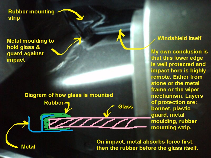

    Examining the windshield edge, no sharp or hard objects come in contact with it. No danger of anything causing a crack outside of a collision itself. Even a stone impact would be near impossible at this edge.
