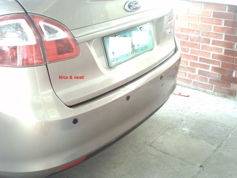

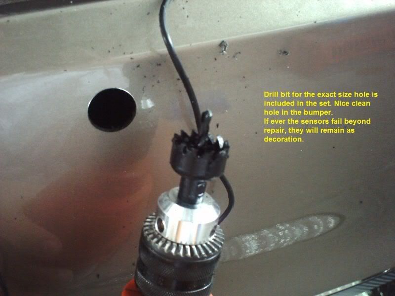

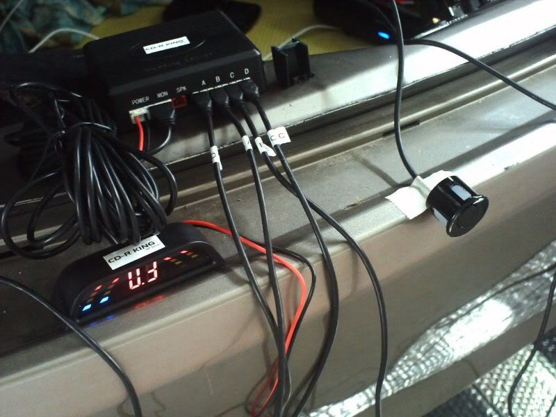

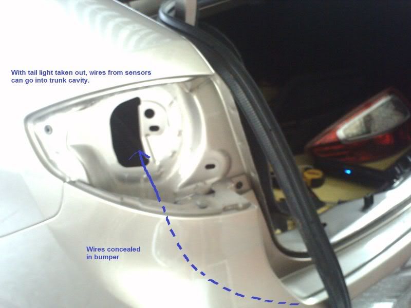

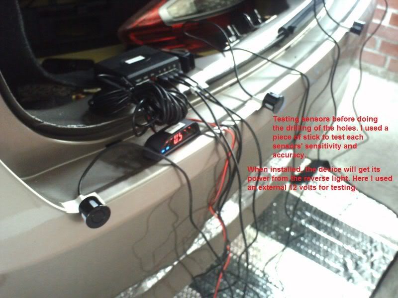

Ewan ko kung mahirap umatras sa hatch nyo, pero sa sedan, it won't hurt to have some backup or parking sensors.
Got mine from CDR-King and here is my procedure:
http://www.youtube.com/v/Wdwf3b4irgE

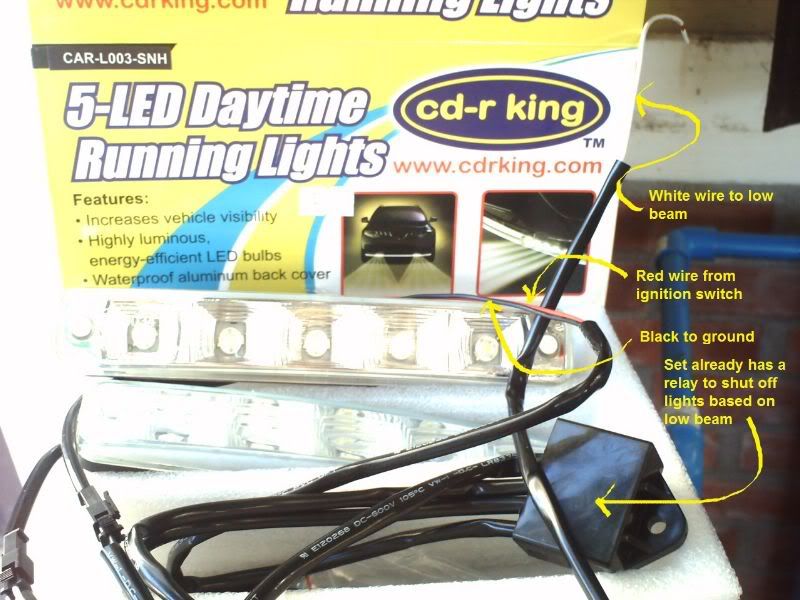

Update sa CDR King DRL:
I decided not to install the 9 LED DRL because they were too big.
Luckily I found an even better set with these advantages:
1. Stronger LEDS
2. Metal housing with cooling fins (although LEDs do not produce much heat)
3. Relay already included and wired so that when low beam is turned on, DRL turns off
Ginabi na ako natapos kaya will post a daytime picture later.
At the time I got the 9 LEDs, they were the most expensive of the brand - 480 petot. These are 580 petot but much much better. The 9 LEDs will surely not go to waste. I can use them for trunk lighting or DRL for our Honda City.

October 20th, 2012 02:47 AM #148
Yes, working like new.
They do not detect low objects like concrete gutters.
Once I backed into one and since my splatter guards are "bell bottom", the gutter managed to pry off one screw. Nothing major but my wife was laughing at how I was too confident with the sensors.
I guess anything has its own limitation. Even a branded sensor would not detect low things. It was my splatter guard that was too low.
