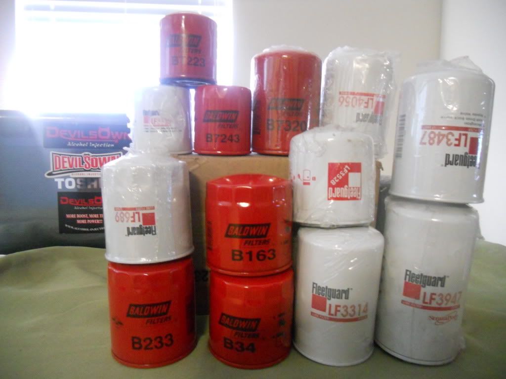

    BTT.. I thought it was the fuel filter youre askin.. 1" as in 1 inch? Even doubling up the lenght of the OE filter would not bang into any component.. I'd get a pic for you on this later.
    Thats another good idea, increasing the filter size means larger volume and more free-floww.. Any recommended Fleetguard part number for the extra size??
    The LF3314 woud be the one you would want to use, It also goes on the Ranger/Everest. Hopefully they have them. I always go bigger than stock on my oil filters when I can. And if you can find the sythetic media version which I posted then you would get some really good filtration down to 5 microns.
    The Fortuner has the smallest filter I have seen in a while it's freakin tiny.
    O.D.: 2 29/32 (73.8)
    Length: 3 1/2 (88.9)
    They could definetly step up in size if space allows.
    I guess they all have no synthetic blend.
    OD(96.06) OH(137.08) - LF551A, LF3313
    OD(96.06) OH(146.43) - LF3314
    OD(96.19) OH(107.29) - LF689
    5mm (4mm to be safe) increase from original OD of 93.5 i think is acceptable, while OH allowance seems to be acceptable at 3inches before touching some plumbing.. here are some pics you have requested..
    Filter Lube
    Fuel Secondary
    Fuel Primary

    That is good to know info, I'll be sure to keep a few of the Microglass versions out for yah when I get back there next Summer.
