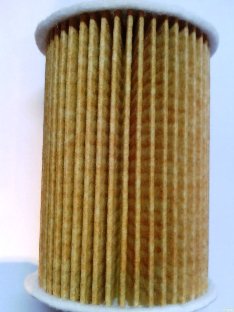

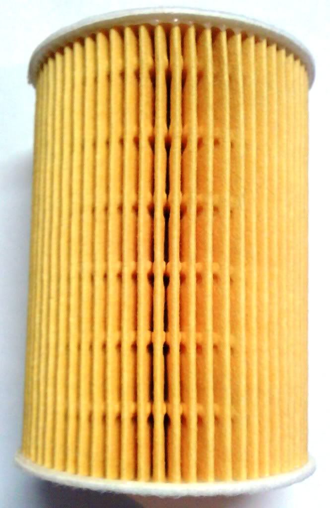

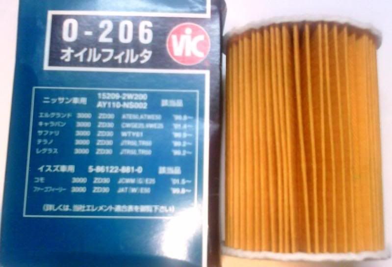

    Vic C506. Looks like the media collapsed.
    Vic C513
    Dec 2007
    Vic C513
    It's not that uncommon to see wavy filter media so that alone does not make a filter bad, The problem with VIC is they still use a very old style of cellulose for there filters with a low efficiency rating and compared to others it is very thin.
    You can see what I mean here. VIC still uses the same stuff as OEM which is just as inefficient.
    Compare that to modern filters with modern cellulose blends
    Very big difference vs VIC
    VIC's are cheap for a reason.
