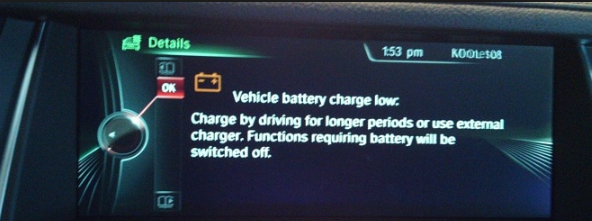

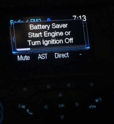

    New cars meron na rin low batt warning. Upgrade ka na lang if you want that feature.
    Sample message below, sana it's not too technical for you...
    Ford's Battery Saver Mode - warning messages and chimes + all accessories will be forced to off.
    BMW
    ADD ko lang,
    Regarding faulty stater,
    If MT, use kadyot method to start.
    If AT, use 2-wire method to start.
    It's not the end of the world.
    Lahat may risk, diskarte mo na lang, how you'll maintain your car...
