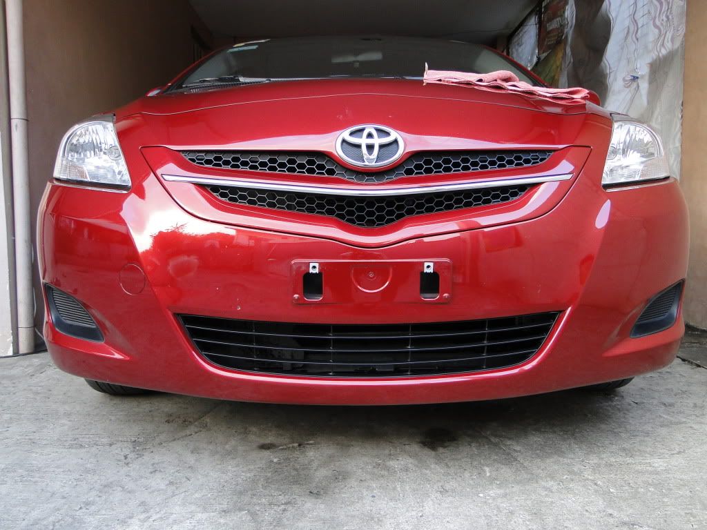

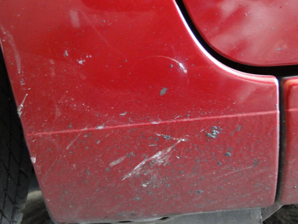

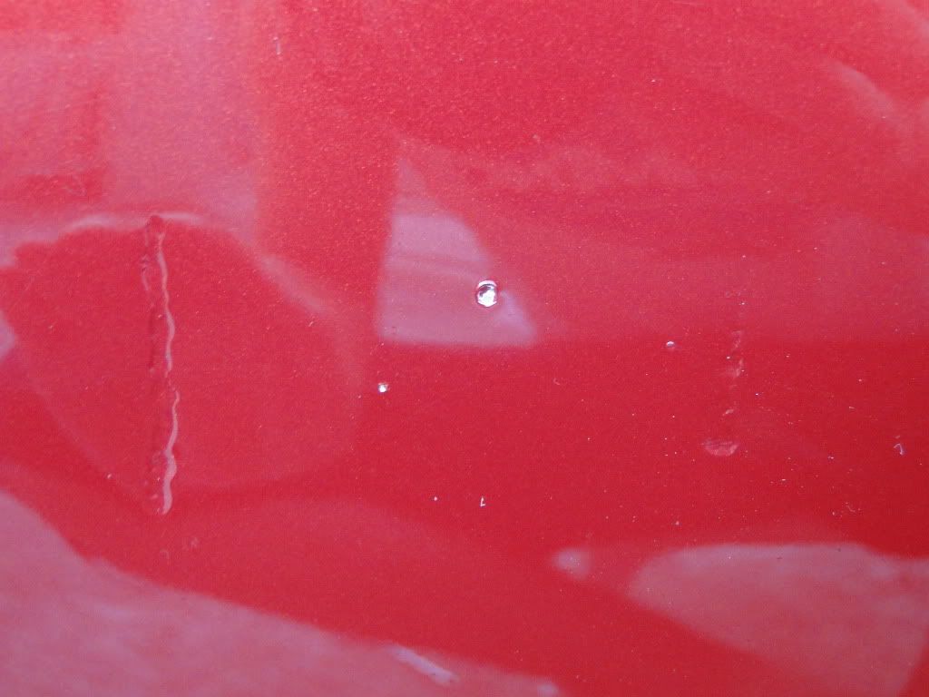

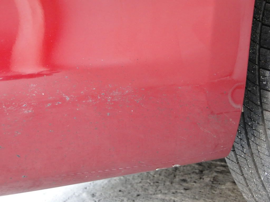

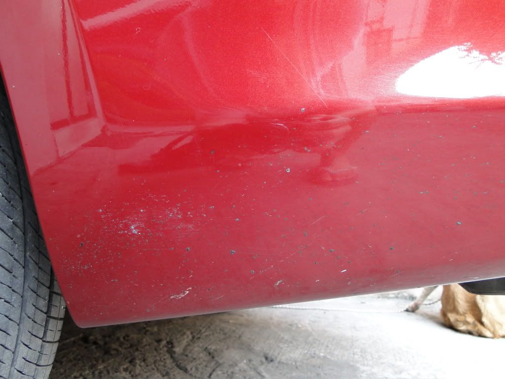

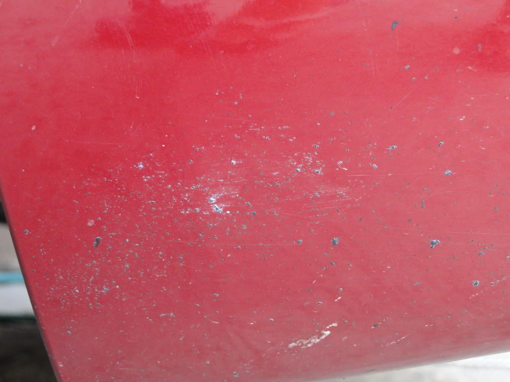

    My current problems..Sana ma diagnose ng mga gurus hehe..
    Front Bumper
    (naatrasan tong part na ito dati pa nung halos bago pa lang si Vios namin sa hanging road while traffic accdg. to my dad. maliliit lang pero medyo noticeable siya)
    Close-up pics:
    (Regarding this pic above:Horizontal na gasgas from the plate number)
    Hoping for your suggestions po on how to remove these or make them less noticeable.. Salamat po ^^,
