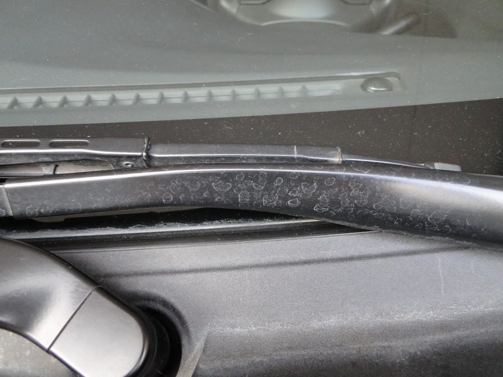

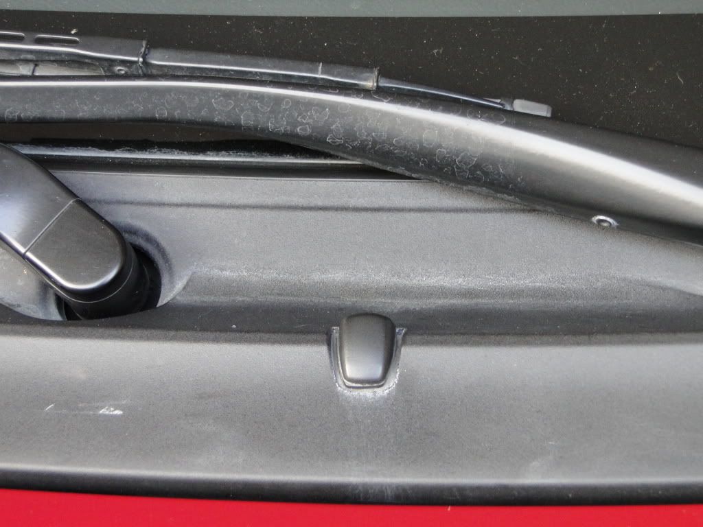

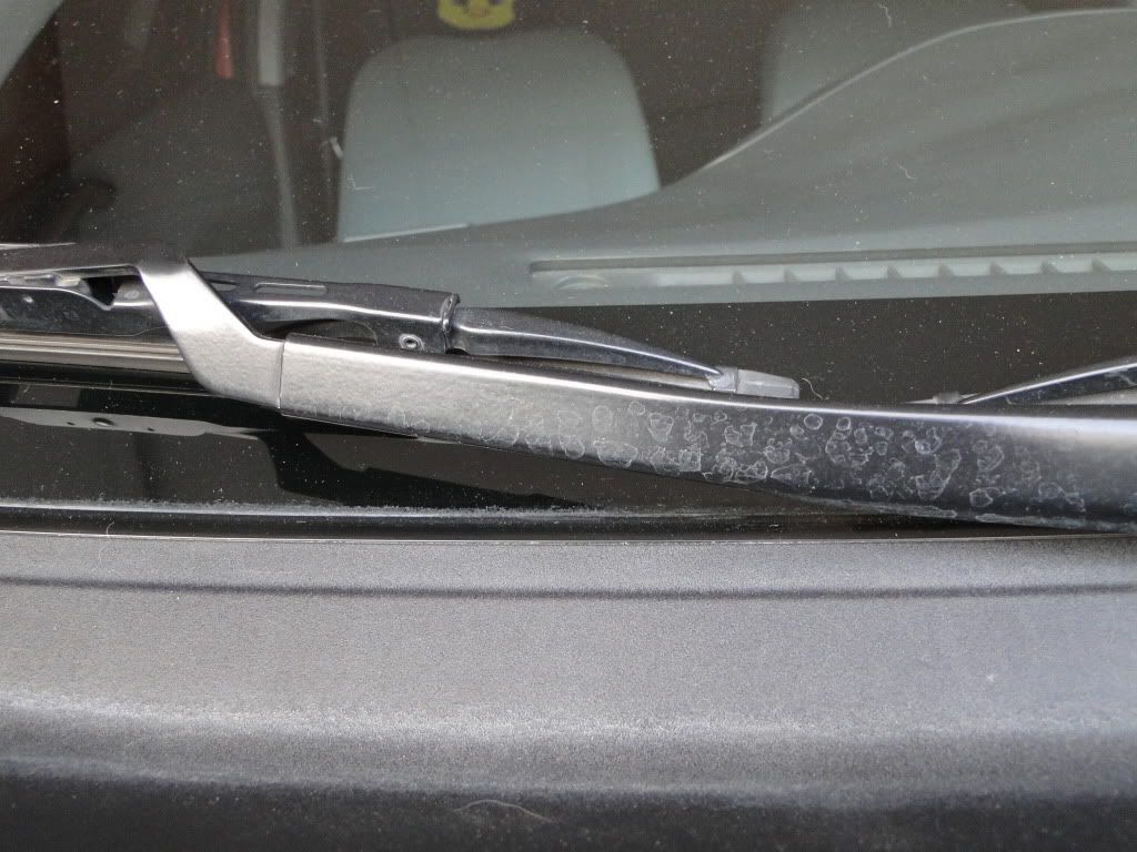

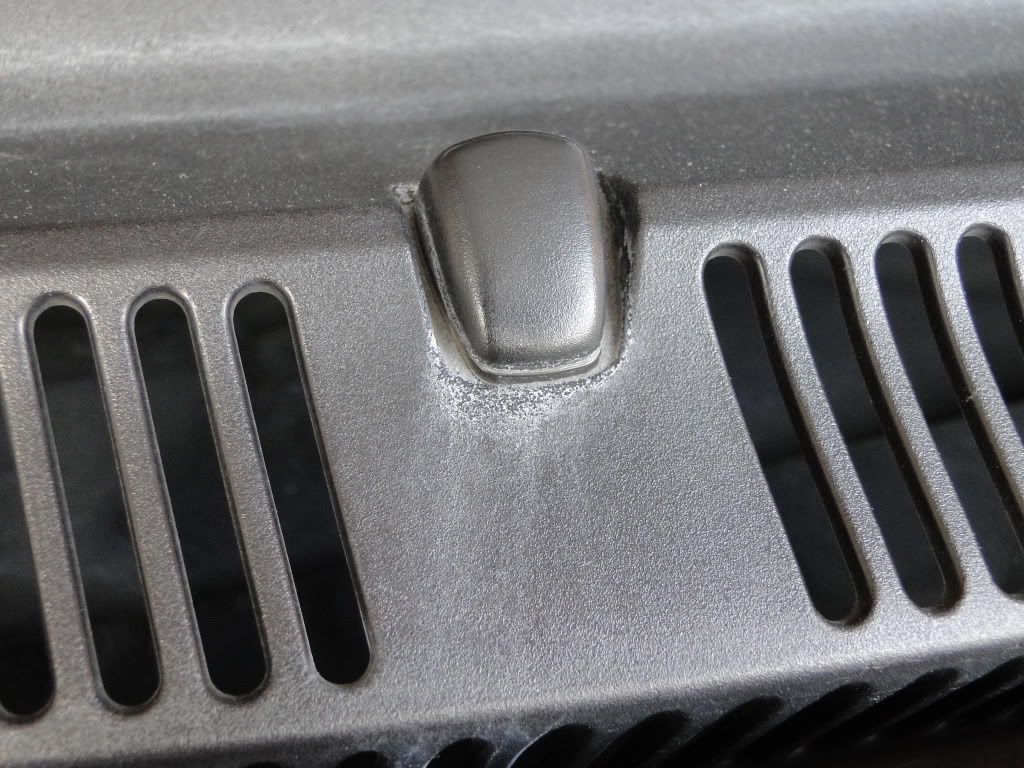

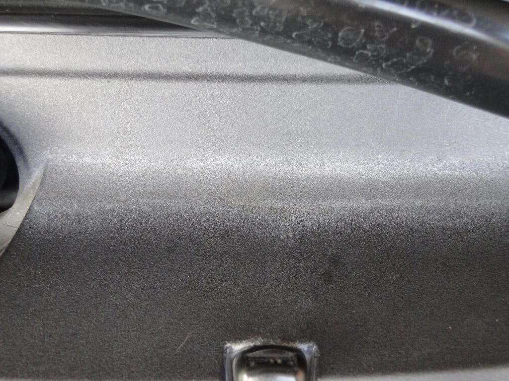

    How can I resolve this problem as well? Paano ko siya mababalik sa dati niyang black and shiny look? Armorall didn't work..
    i only use MC multipurpose cleaner + old toothbrush for this problem. then apply Armor-All protectant Gel. for the heavy watermarks sa wipers ng old car ko, Back to Black works well ren for me..
    HTH somehow.

    Quote Originally Posted by badbadtz.carlo View Post
    HTH somehow.
    Wet sand with 2000 grit sandpaper (basain po ung liha) then use 3M rubbing compound then use 3M polishing compound. Read instructions na lng kung paano i apply mga 3M products. Sa ACE hardware meron.
    BTW, I used to be a bodyman and painter sa states. Sa lahat po ng may mga katananungan sa automotive paint and body repair feel free to ask me.
