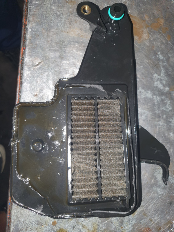

    Thanks Bro, Around 72T km, Is it advisable to change also the tranny filter or just drain and fill will do?
    Drain & fill is still better than believing the fluid is lifetime. Best if you can do it twice w/ some good driving in between.
    Changing the filter would require dropping the pan, cleaning everything... including thorough removal of the old RTV & proper reapplication of the same high temp sealant. Plenty of brands out there. ThreeBond is a popular old 1. Pioneer has its version.
    Your call on the filter.... For reference, here's how a 50k km pried open Sky tranny filter would look like. Not as filthy as one would anticipate.

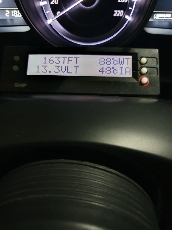

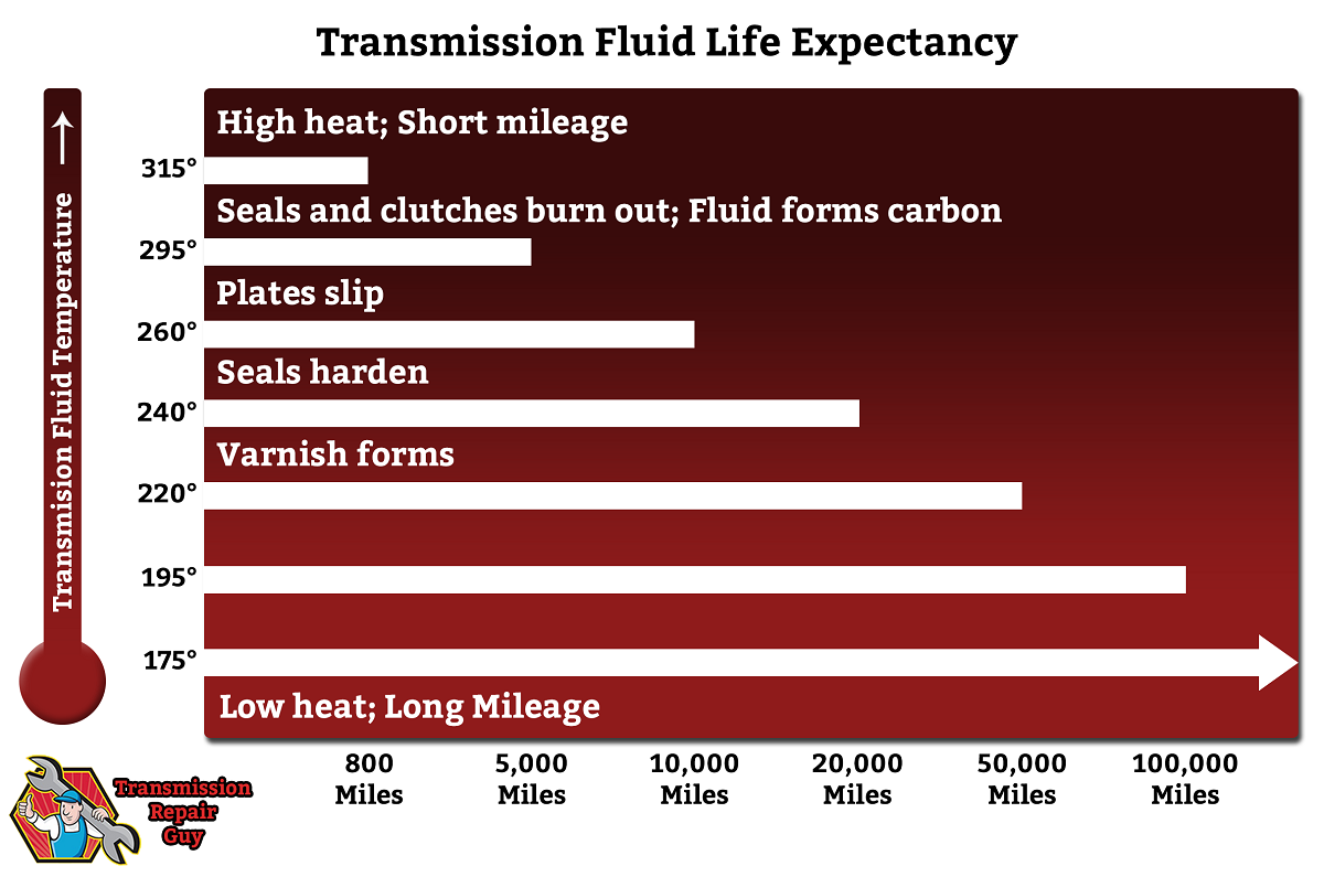

    Though the Skyactiv FZ fluid is labeled lifetime, one could follow this guide for ATF change interval. (Note: not for CVTs)
    However, a Transmission Fluid Temp gauge is needed to know the heat range the car is operates in. The Scangauge2 can extract the TFT(°F only) in Skyactivs.

    Though coolant & TFluid temps can be close, they won't always be.
    Mazda uses a variety of codes to report sensor values. Scangauge requires those Mazda-specific codes for TFT to be extracted. Does Torque require them, too, brother John?
    None of that sort.

    Torque will report whatever the ECU sees.
    With Scangauge, it does read what the ECU gives, but Mazda has specific codes for TFT to work right.
