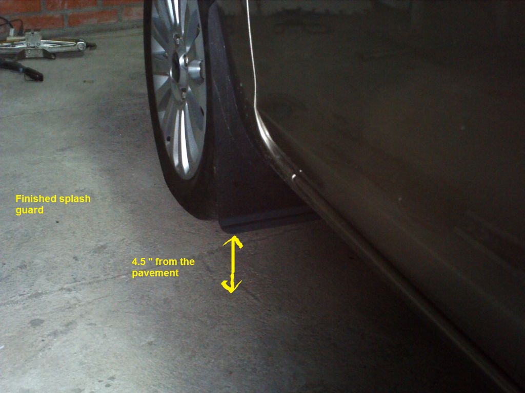

    If its any help to you...I just measured my original oem Ford mudguards on my hatchback.
    Front is 5 inches from ground, rear is 7 inches. The hatch has a short overhang at the rear, so I imagine your sedan mudguards will need a similar ground clearance as the front.
    Thanks!
    The formula I found is 1/3 the distance of the center of the wheel to the face of the fender liner where the guard is to be installed. My measurement is 13.5" which results in 4.5". Your 5" may have been for aesthetics which I am not too particular with in this installation. I have plans of putting in similar ones like yours (any pics, BTW) when they become common and lower priced here in our Province.
    I followed the formula in my rear guards and it worked like a charm. None of that gritty splatter on the underside of the rear bumper when I last washed it. These front ones are yet to be tested.

    these are actually good looking sir! parang Rally Armor mud flaps ang dating.
    keep up the good work sir! your posts are very useful and informative!

    While I'm waiting for the chance to get Splash Guards as pretty as yours, rainy season has started.
    Like my rear ones, which I put in as an interim measure, I felt the need to have the front too with all the mud that suddenly abounds.
    My aim was to have the guards as wide as possible and elevated 4.5" from the pavement. You will see in the following pics that the ones I got are as wide as the wheel cavity. I think they are for off-road use. Printed with large FORD which I cut off finding it too "loud".

    Medyo hiya nga ako i-post dahil makisig at lapat na lapat na yung mga nabili ng iba natin kasama dito sa forum.
    More on electronics kasi ing trip ko at hindi talaga sa automotive. Dito lang ako medyo natuto. Kaya hindi ko alam ang term na Rally Armor.
    Here is another picture showing the embedded fibers on the tire side of the flaps:
    Ang dating nila heavy duty na parang pang off-roader. Mabigat at makapal.
