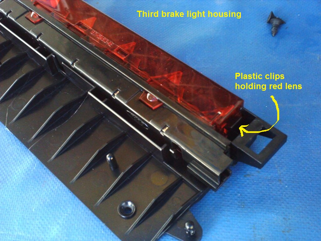

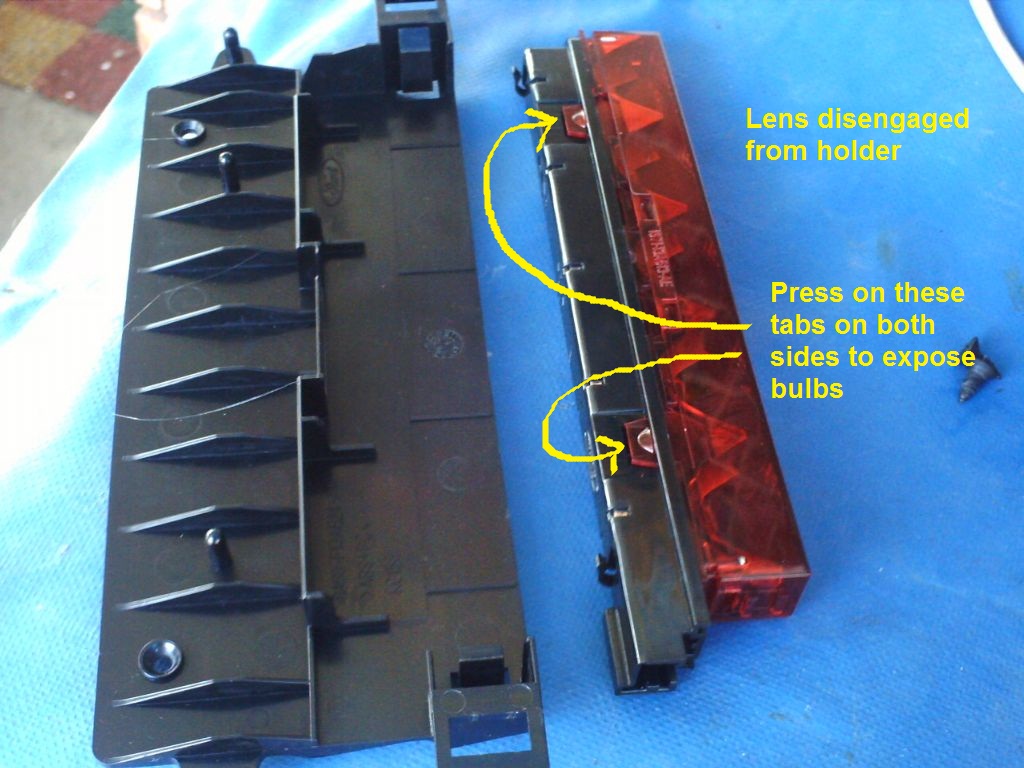

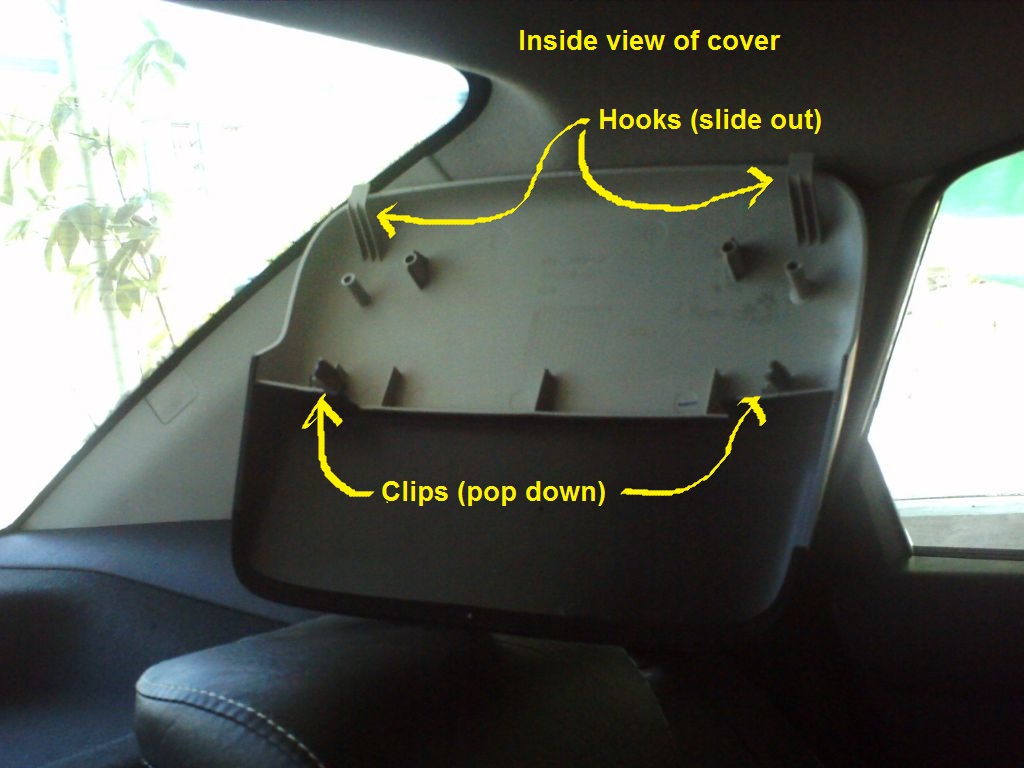

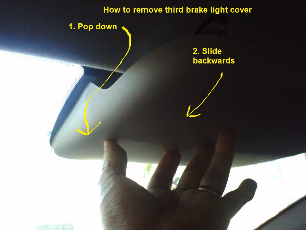

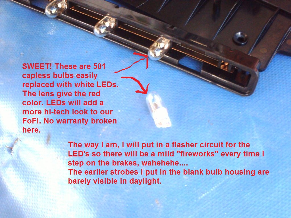

    I seem to have missed this in our manual. How to replace the third brake light bulbs.
    The brake strobes I did some time ago are not good enough for daytime and I had my eye on this third brake light for some time. I want it to flash upon braking.
    Doing the investigation today, here are the givens:
