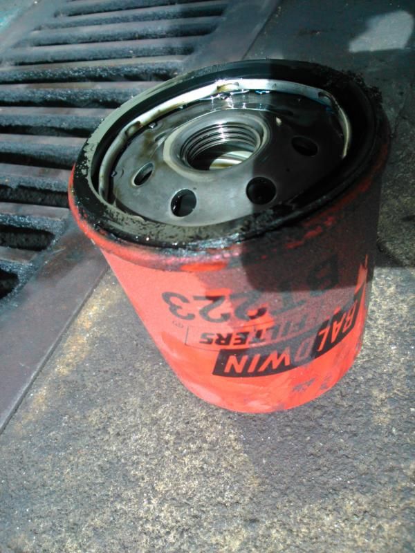

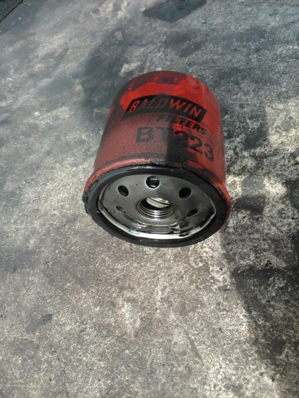

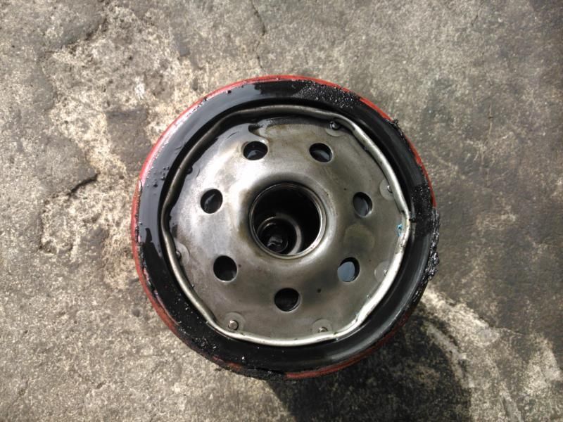

    We recently changed the oil in our Grandia (2.5 D4d) and i noticed that the rubber gasket may have failed on the BT223, or the Toyota mechanic who did the last oil change miffed up the install. The filter was on for roughly a year and two months and 6,000kms (Toyota FS). There were no visible leaks in the engine bay area or where we park the car (save for some oil residue where the filter housing is) and we had to add around half a liter of oil late last year.

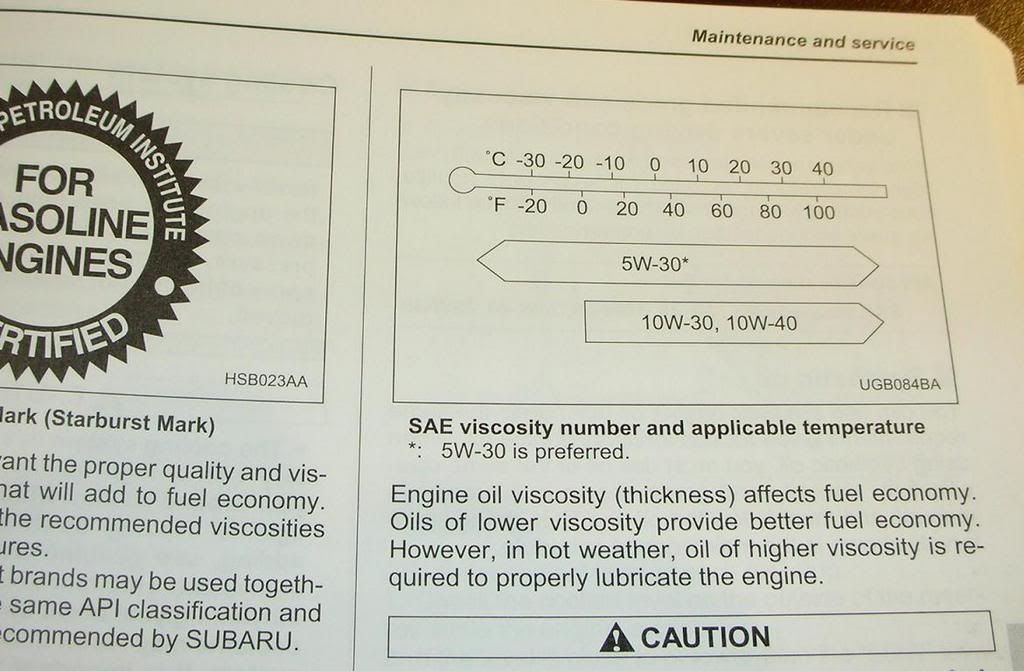

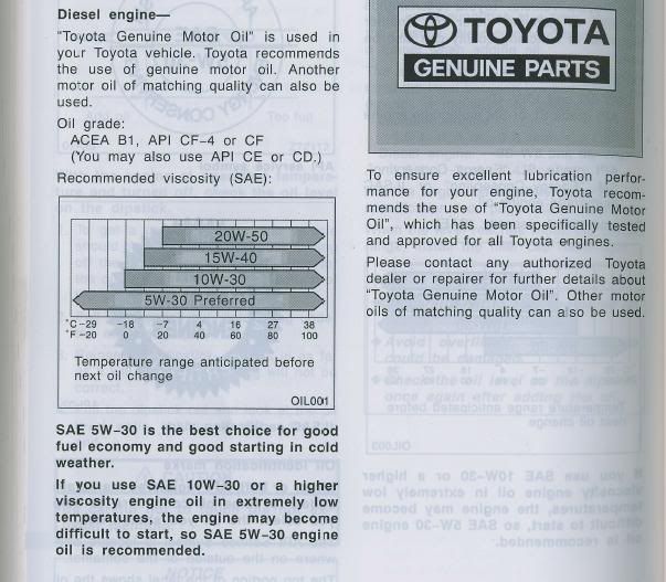

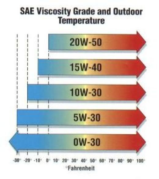

    Ito yung post ni dvldoc na tinutukoy ko at advice din ng mga experto sa bob is the oil guy forum.
    Since this gets ask so much just want to break it down to it's simplest form. You should be running oil based on your climate if you look in your owners manual you will see a chart what what type of oil you should use in what climate. But here is the simplest break down I can give.
    The recommended temperature range are as follows
    10w30: -13 F to 100 F (-25Celsius to 38Celsius)
    10w40: -13 F to no limit (-25Celsius to no limit)
    In other words the difference between the two oils if you are hesitating in switching over is that, the 10w40 has same performance at low temperatures, but works well also above 38C/100F. Your vehicle will experience above 38C in Manlia trafffic meaning 30 weight oil will break down quicker and provide less protecton. But if you live someplace like Baguio you can run 30 weight oil year around.
