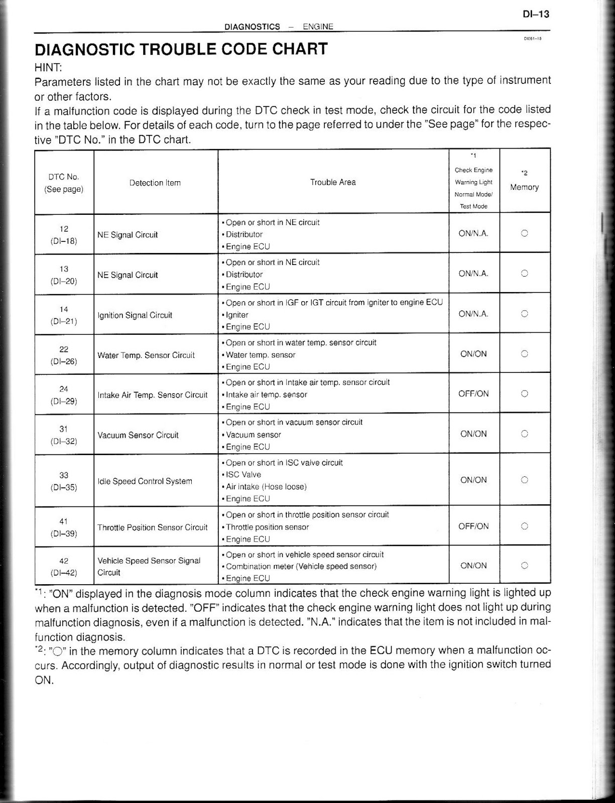

    OBD1 ang 1RZE revo, merong scanner pero toyota specific. May mga nabibiling parang mga adaptor for this para maiconnect sa mga universal scanner kaso very limited ang compatibility. If ever may problem sa ecu at umilaw ang check engine light, you can diagnose yourself by putting the ecu in diagnostic mode and then observing the blink of the check engine light and knowing the codes if you have a chart of the diagnostic error codes.

    baka makatulong for engine codes
    7K-E Service manual Page 80Buku Manual Toyota Kijang 7K-E ( Kijang Kapsul EFI) - Iman Suherman)
    1RZ-E Service Manual FI-25(Page 5 ng PDF)
    https://cardiagn.com/efi-diagnosis-s...1rz-e2rz2rz-e/
