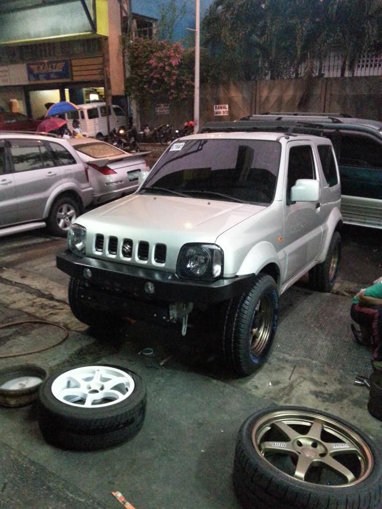

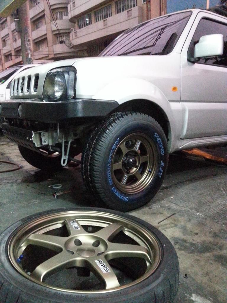

    Replaced 4 tires only to find out that the tie rod ends need replacement. Ugh! Another weekend of spending.
    1,736
    #2890
    Was your worn tie rods making noise or vibrations?
    #2891
    Quote Originally Posted by K.I.L.L. View Post
    Vibrations and made the death wiggle more pronounced. So far the wiggle went away but I havent tested it yet with the 70-80 kph run.
    #2892
    Update: drove the jimny on the skyway and reached 100kph and felt no wiggle at all. Steering felt light though but cant remember how it felt when it was brand new. Changed 4 tires with dunlop 205/65/15, 4 tie rod ends, balanced and aligned.
