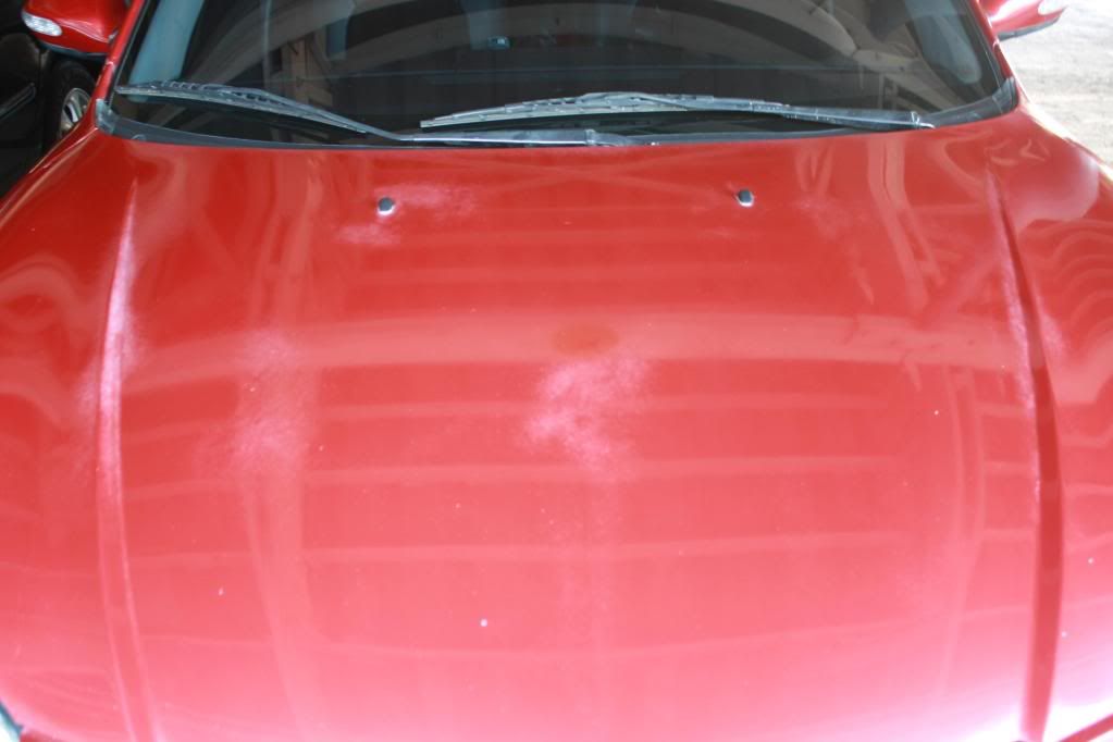

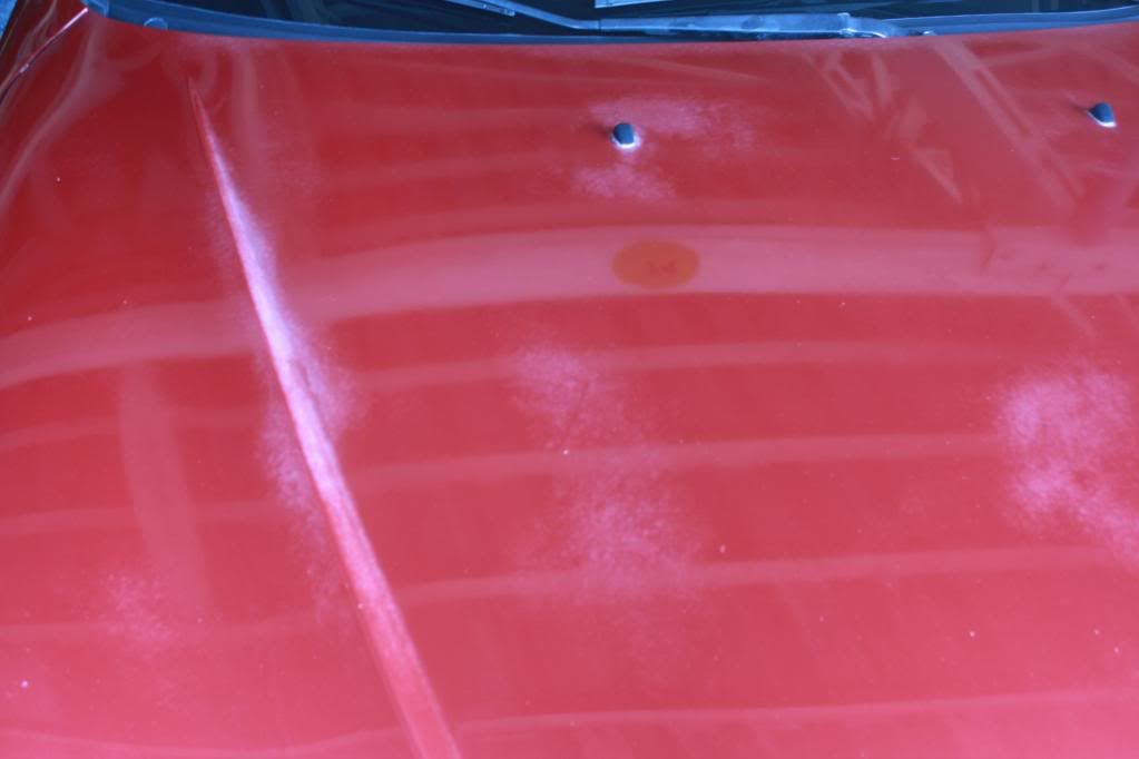

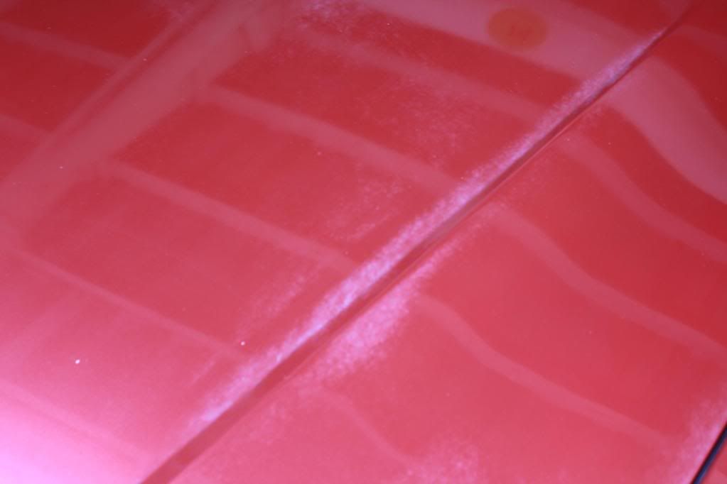

November 2nd, 2009 04:13 PM #2930Hi mga sirs,
I need your help badly. There are some white stains on my hood and hood only. I'm not sure if this is the paint fading or kung may mantsa lang. Texture is still smooth though not as smooth as other parts of the car. I'm guessing it has something to do with the heat since sa hood lang meron. At first parang nawala lang ang kintab but lately it's gotten worse. Parang may white mantsa na! Halp pls hehe
Here are the pics:
Thanks mga guru!
Edit: I just read the thread on the 1st page about paint oxidation.. Is this the case?
