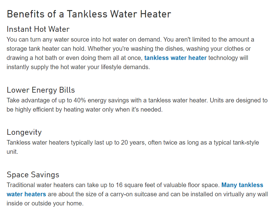

    That general data is vs conventional centralized storage unit use where it's left on all the time....relying on the thermostat. The system I shared above was more an empirical hybrid. Individual, low capacity, low power, switched on upon demand, off when done.
    Real everyday life doesn't always follow everything we read.[emoji4]
