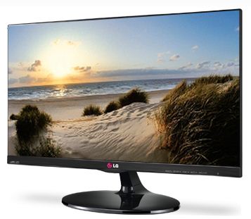

* Monitor: The LG 23EA63V is an IPS monitor, which means it has much better colors than the usual monitors other people have. It's also wall-mountable if you're into that. Looks great too:
