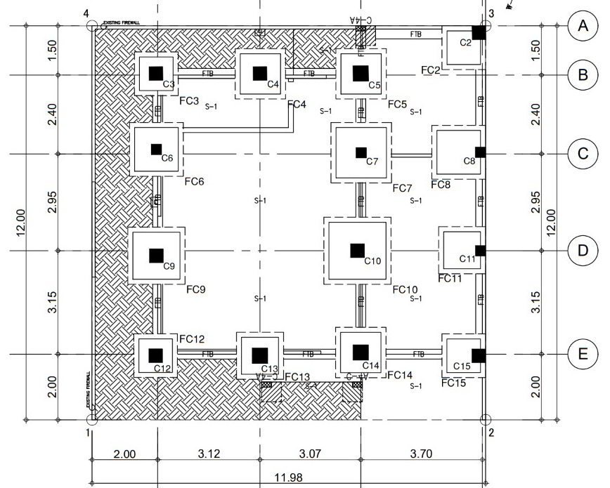

    Distance between column sir?

    around 3 meters sir....
    https://i.postimg.cc/DZKkvpGn/Posts.png

    Haha malaki nga sir [emoji16] anyway wala naman namamatay sa ovetdesign masakit lang sa bulsa [emoji5][emoji5] You can chip off were you can hook up your dowel on column and it will no affect the integrity of your column [emoji106]
