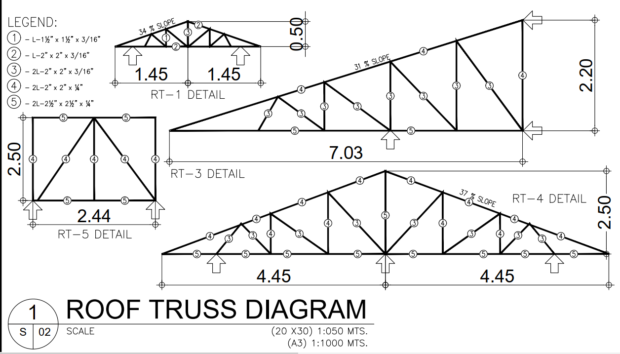

    Here's my truss details, that RT-5 is supposed to join the trusses together, is that necessary given the trusses are secured by purlins? Or maybe not that whole detail but just a long angle bar running end to end to hold them together?
    https://i.postimg.cc/brKmdWRQ/Roof-Truss-Diagram.png

    Test upload
    I can't upload my truss plan pic
    There are many ways to skin a cat, sir.[emoji4] Here's another...

    Test upload
    Your design indicate 2L x 2.5x2.5x 6mm same as travs detail. You just follow your design and since you downgrade your angle bar size better look for standard thickness.

    Thank you very much Sir Travs and Sir Max!
