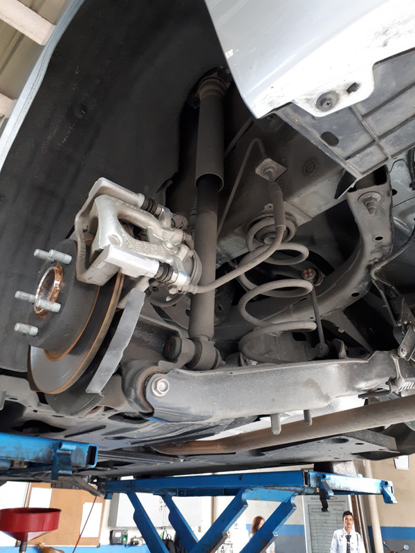

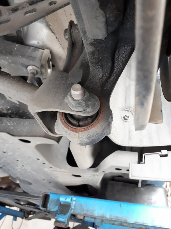

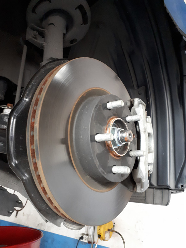

    Just one year old and there are already some rusts around the brake disk and other parts at the suspension area
    Sir, normal lang yata ang ganyan sa lahat ng cars, suspension parts are not made of stainless steel kaya it's normal rust to form around that area.
    But compared to the 10 yr old Mazda 3 we have, those rusts at the 1 yr old M3 are much worse.
