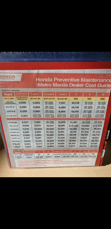

    Mine just passed its 4th year but is still at 57K kms.
    Looking at the table below its Php30K for the 4th year of the diesel CRV wow!
    to keep warranty.. change oil every 6 months. affordable naman.

    I think every fluid on the 48th mo is replaced. 10L of coolant na type2. Thats already 7000pesos lol. A 6 liters for the ZF transmission, thats 7000 also. Brake fluid is only 1L or so. Patanggal na lng yun X1R para makatipid lol
    Many folks don't follow the intervals.
