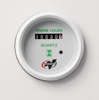

    Is that an engine operating hours meter? How much did that set you back? Sounds like something we might want on our ambulances. Our GM ambulance has it, but our regular local ones don't.

    hour meter is a Nordskog like my old. boosr guage and my current volt meter its for marine use so its heavy duty got it on ebay for 25usd.

    This is the hour meter I have. They don't make them any more though, Nodskog is out of business did make some great gauges.
    Nordskog Viking Series Marine Analog Gauges GWCB100HM - SummitRacing.com
    I like having a hour meter because you know the total running time of your vehicle and not just how many kilometers especially if you spend a lot of time idling in a diesel and affect your maintenance schedule. If you live in Manila you spend a lot of time standing still.
    Yup. While we try to keep track, it's difficult. Nice to be able to see how much time you've spent with the engine on versus kilometers. Helps in planning oil changes if you're on extra long intervals.
