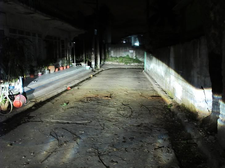

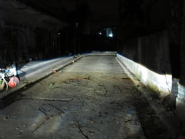

    *NH: Nice write up, ganda ng mods
    love pics with the light throws!
