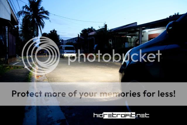

    Hi Gary, I'd like to know your thoughts on what I can do with my car.
    I recently bought a 2004 Mazda 3 2.0R. It comes stock with halogen projectors and manual leveling. The previous owner installed plug and play HIDs (8000K) on the car.
    When I drove the car, I felt very disappointed with the low beam output, which I thought was due to the poor quality of the PnP HID. Also, I noticed that the high beam was severely unaligned, with the left headlamp much higher than the right. And no matter how much I adjusted it, the level did not move:
    To try and rectify the situation, I went to Banawe today and reverted to a stock setup. I bought Osram Nightbreaker Unlimited bulbs and stock H7 sockets. I expected the output to be at least as good as my other car with reflector halogens and stock bulbs. However, the lighting was just as bad, with absolutely no cut-off:
    I tried aligning the headlamps using the screws on the headlamp housing, but the headlights don't adjust. When I use the manual leveling switch, the motor on both headlamps start making sounds, but only the one on the right actually moves.
    I'm not looking for stellar output (I'd have gone straight for your retrofit if that was the case). I'm just looking to return the car to the stock OEM lighting output. Could you advise if this is still possible? What repairs should I do with my current headlamps? Thank you.
    17,314
    #2340
    Not sure if it helps in diagnosing the car, but it's very weird that when my fog lamp switch (the one on the stalk behind the steering wheel) is off, the lights of my HU also turn off.
    Doesn't matter if the fogs are actually off (since they can only turn on if your park lights/main beam is on), as long as the switch is in the "on" position, the HU LCD lights up.
    Also, here's a video showing that only the right leveling motor works:
    https://youtu.be/yhoDnwTThA8
