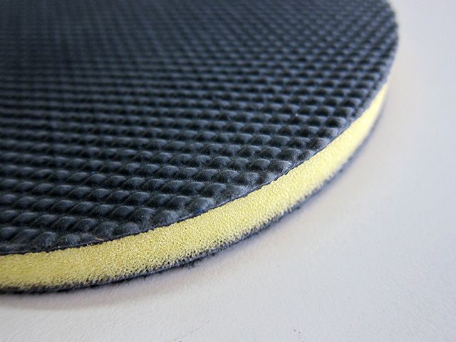

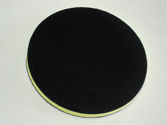

    My new tool - 6" Clay Pad. Para mas mabilis magtanggal ng embedded contaminants, watermarks, etc. Can be used over 60 times. Just rinse with water to clean the pad. For hand use or machine use (DA polisher or drill kit).
