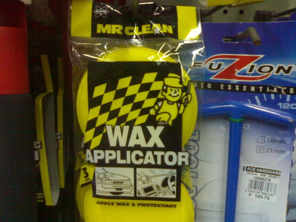

    BTW, I saw this Mr. Clean applicator pad sa Ace Hardware sa SM Valenzuela yesterday (not the mr. clean soap logo, kulay yellow and black ang kulay ng package/logo niya).. AND, it only costs P99.75 for 3 applicators!
    But heck, it's softer than the SM Arnolds! Not worth it IMO.. Konting kurot mo lang with your thumb and index finger pisa na agad.. Baka pag ginamit mo yun tagos agad ang wax sa kabilang side ng applicator..:bwahaha:
    Here's a pic of it.. 3 pcs. yan, close up lang yung pic.. cellphone cam lang
