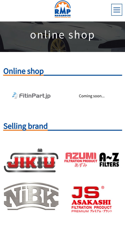

    I think our member JapanABC can vouch for them.
    JIKIU is a subsidiary of RMP Nagamochi. they're legit.
    Sep 2019
    107
    Thanks sir! Sana mabasa to ni JapanABC hehehe. I'm planning to buy it sa onlinestore nila Fitinpart.sg. shipping is free as well upon checking.

    Thanks sir. CX-5 and Mazda 3 is using the same bushing for lower control arm. The big one does not have parts number as well for M3 only the small bushing.
    I already checked with Golden Isuzu and they only have the assembly which is around 9k+ php per piece i think.
    I might try Jikiu replacement bushing and hopefully the quality is good given that it is from RMP Nagamochi Japan(they also sell JS Asakashi).
