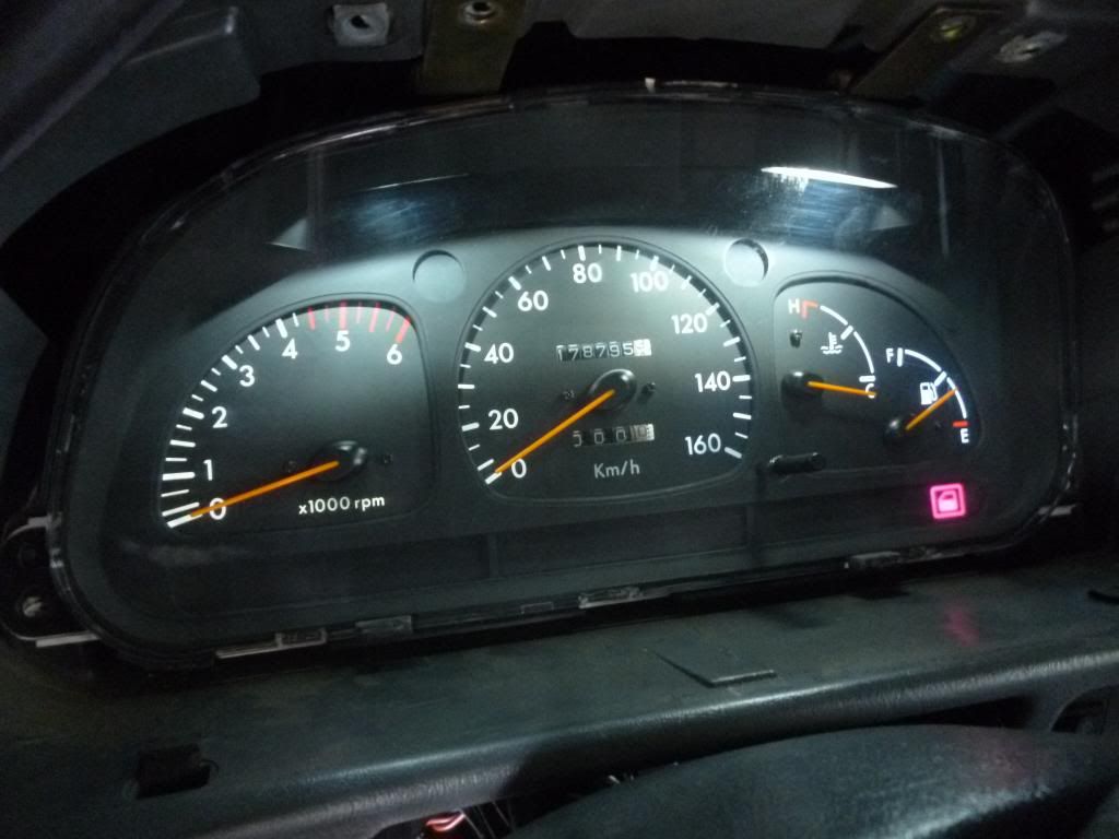

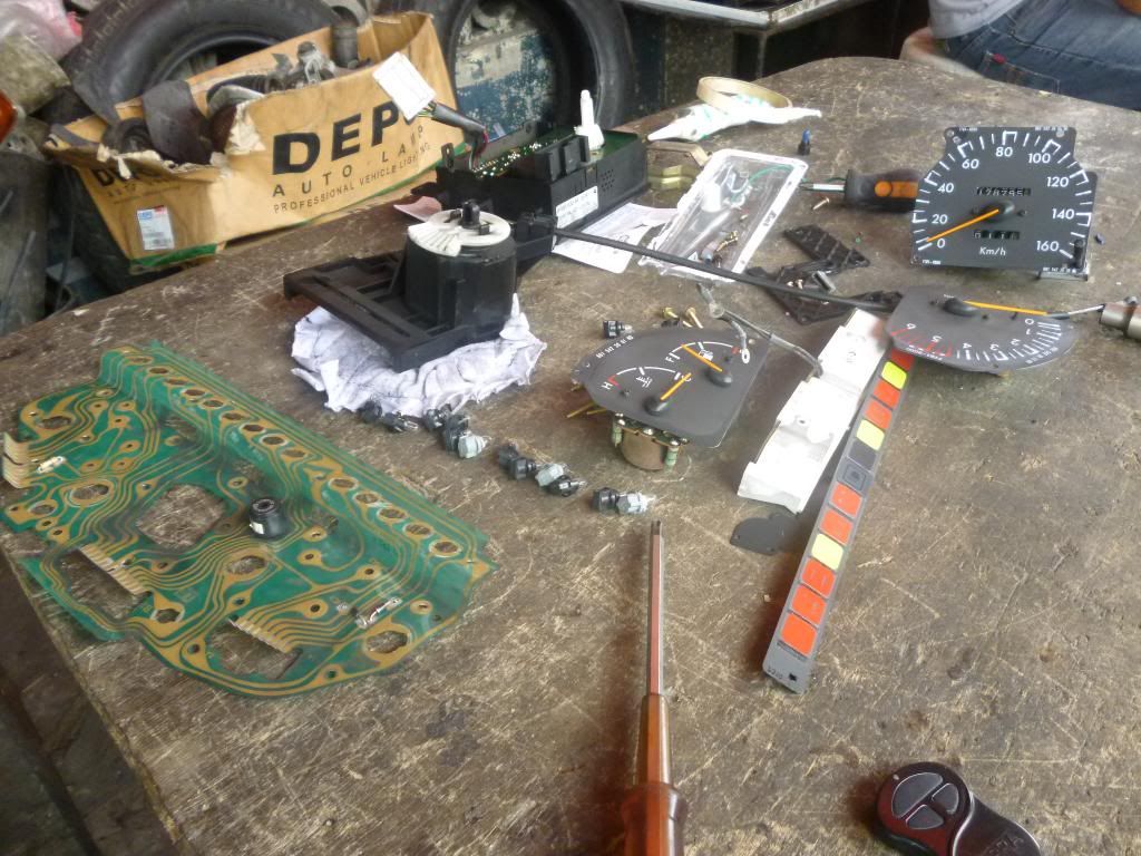

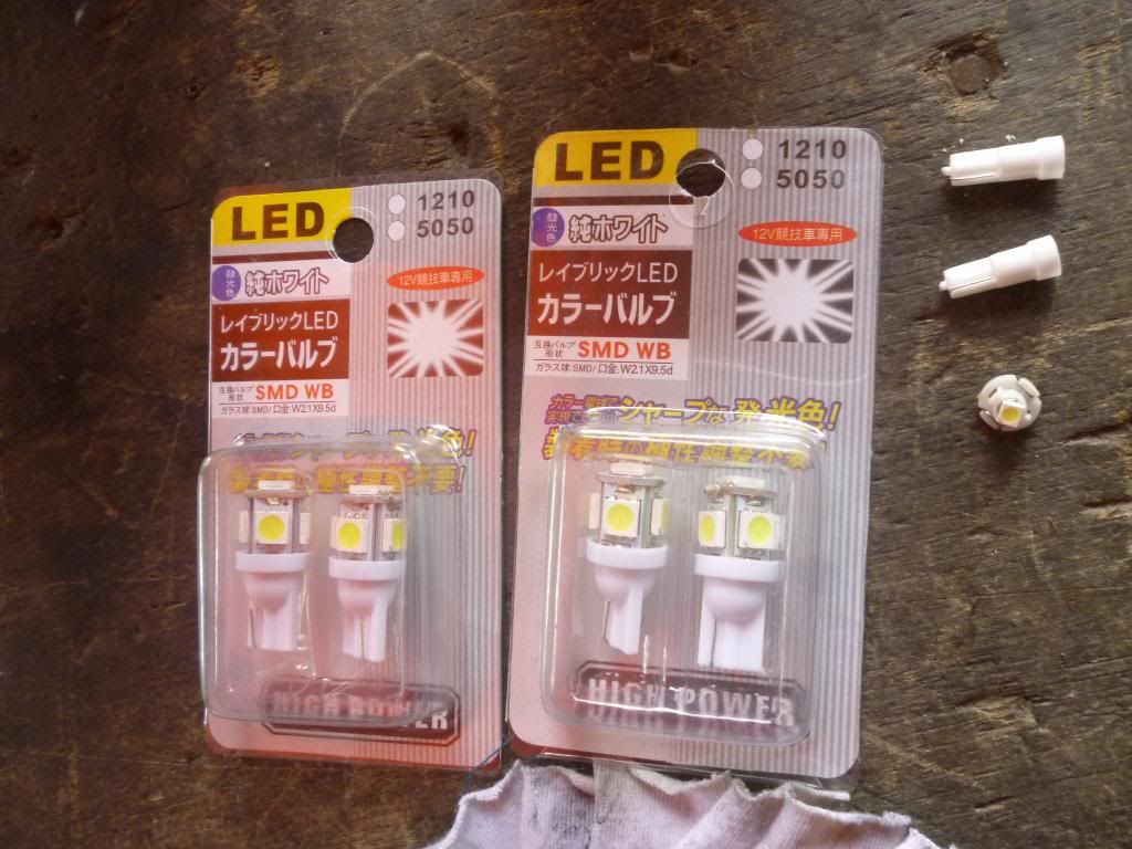

    Instrument Cluster Cleaning and LED Gauge Mod by Jemson:
    You may bring your own LED's or ask them to purchase some for a nominal mark up:
    Result. We later removed the front lighting of the gauges (common to Mercedes Benz vehicles) and left just the back lighting as the front lights were causing glare on the windshield:
