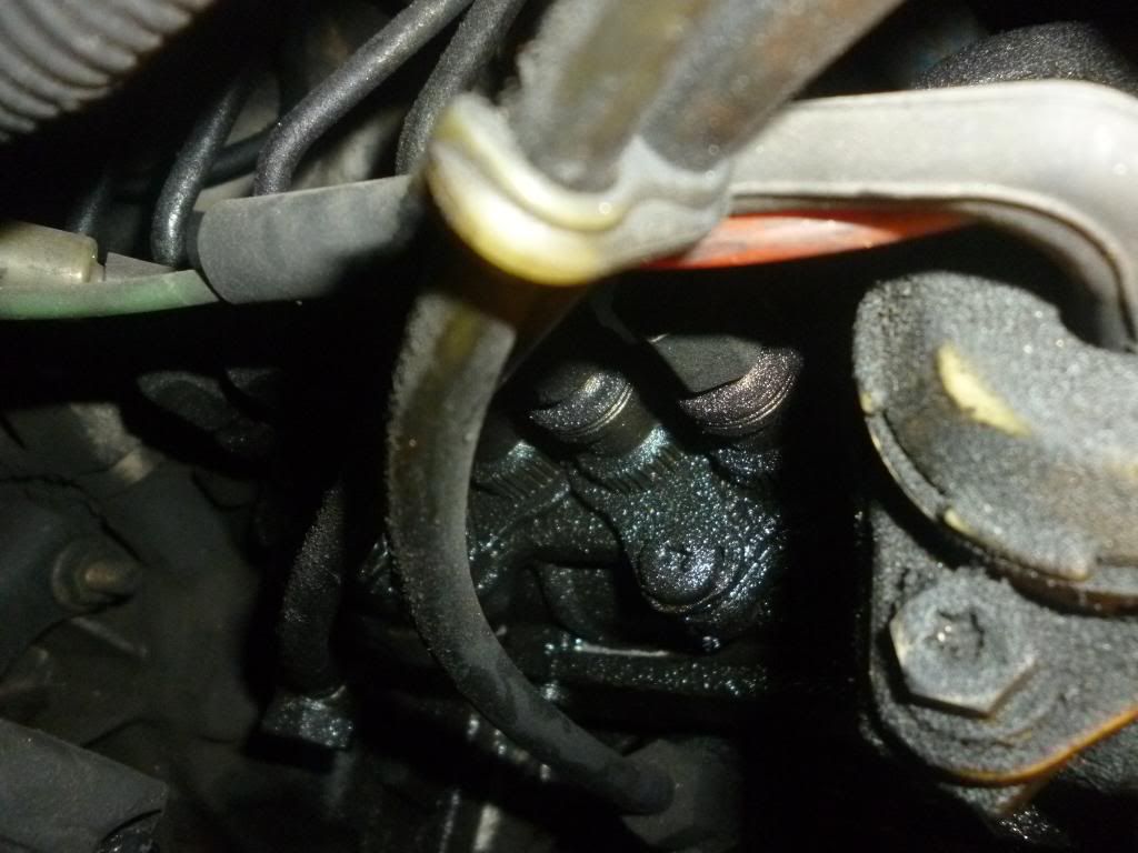

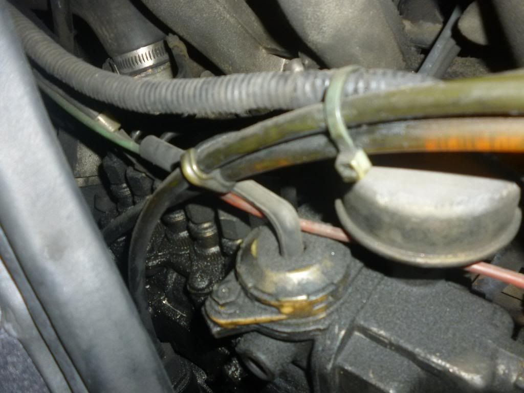

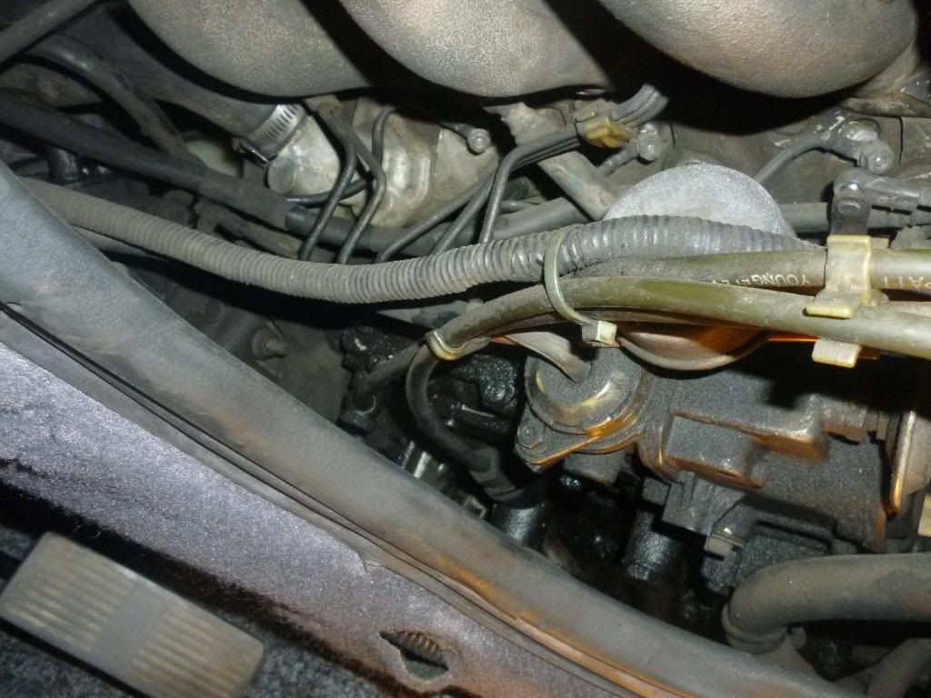

    Help.
    Whenever I park the MB100 overnight, sobrang hard starting sa umaga. Sometimes even requiring more than 5 long attemps. I don't think its the glow plugs since the glow plug fail indicator (glow plug logo illuminates while driving) does not light up. It seems that while parked overnight, the fuel in the fuel lines disappear through a leak or back flow. Yes, there are some drips of fuel (not enough to fill a saucer/platito) on the garage floor.
    When we opened the doghouse, this is what we found. Anyone have a similar experience and solved this problem?
    http://docotep.multiply.com/

    Help.
    sir otep parang galing sa O-ring ang leak
    dati nag leak na din sakin dyan... pero hindi ko naman na experience ang hard starting

    Sir OTEP nangyari na din sa akin yan, o-ring lang yan. Sa akin pa nga pag naka park na nakataas ang harap ng van ng mga 1 day hard starting na.
