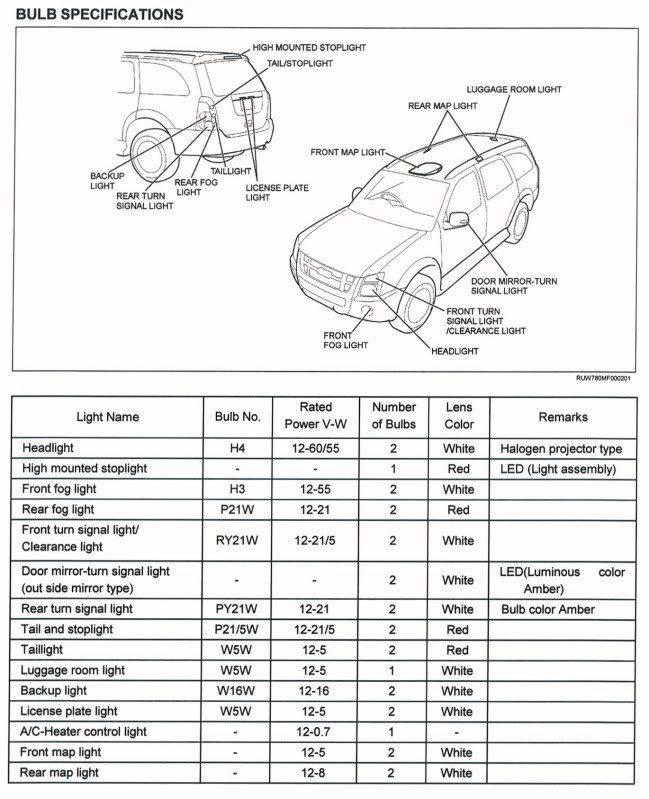

    hi benz, can you provide me like this for isuzu alterra 07 edition (circle ang fog lamps) please....hehhe thanks po in advance
    My pleasure....
